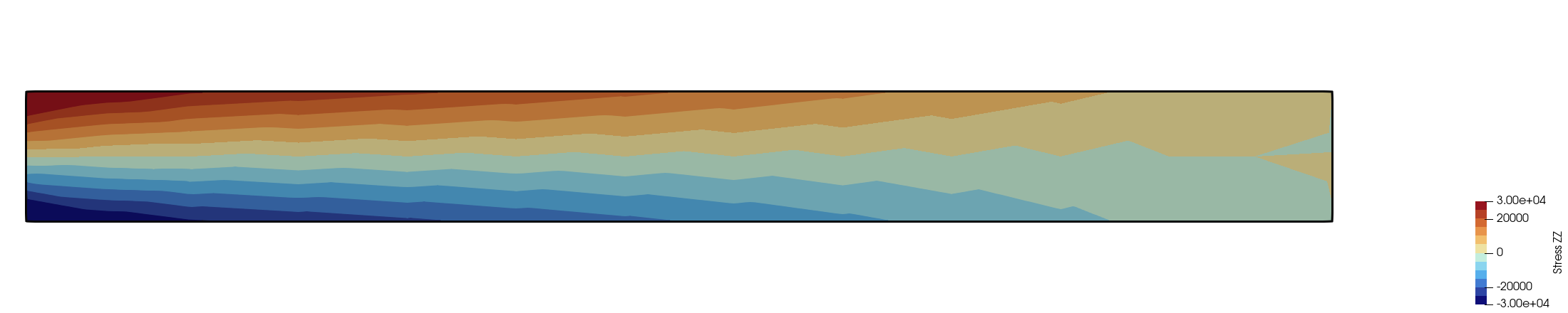

7.4.1 Contour plots
Coreform IGA for Abaqus
Abaqus reference

7.5.1 Contour plots
Abaqus reference
