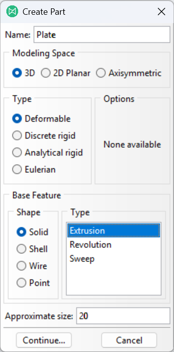

Click on the Create Part icon to open the Create Part dialog to create a new part with the name: Plate. You should ensure the dialog’s parameter-value pairs are set as shown in the table and image below:
Parameter Value
Modeling Space 3D
Type Deformable
Base Feature Shape Solid
Base Feature Type Extrusion
Approximate size 20
After entering these values into the dialog, click the Continue button to proceed to sketching.

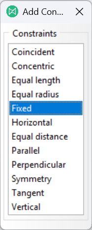

Next click the Add Constraint icon to open the Add Constraint dialog box and then click on the Fixed item as shown in the image below.
The viewport will prompt you to select the entities for the fixed constraint; select the vertex we just created and then click the Done button. You should now see an annotation next to the vertex denoting that a “fixed” constraint has been applied.

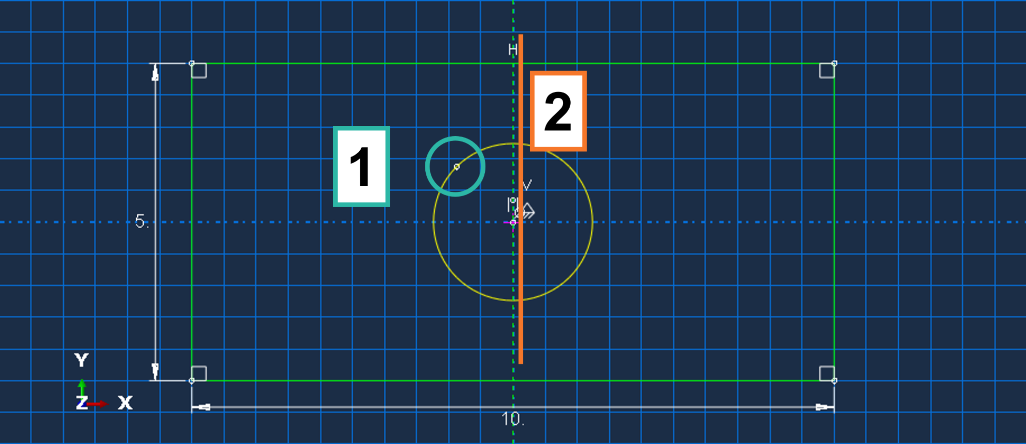

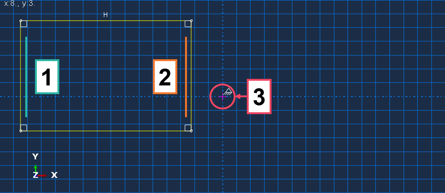

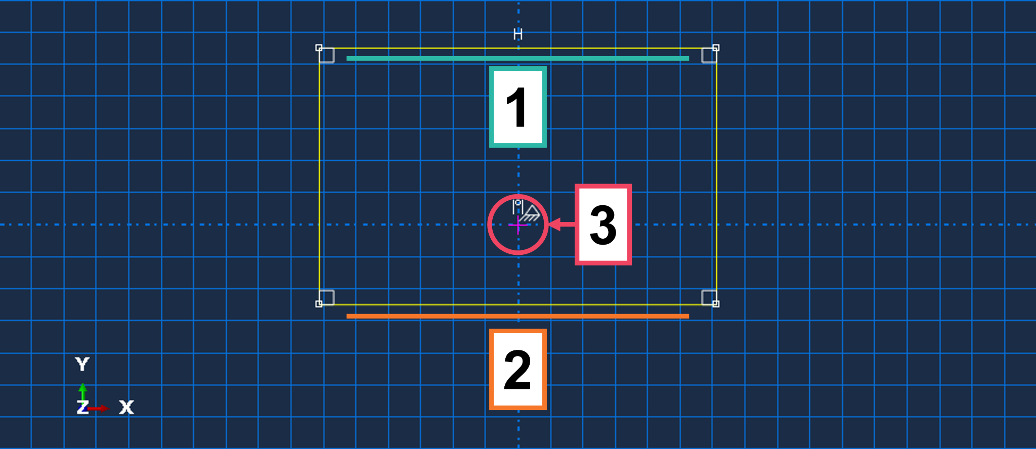

Next click the Create Lines: Rectangle (4 Lines) icon and pick a starting corner and ending corner by clicking in the viewport. The precise coordinates don’t matter since we will specify these via dimensioning and constraints.
Opening the Add Constraints dialog again, click on the Equal distance item. The viewport will prompt you to select:
  1. The first line (or vertex)
  2. The next line (or vertex)
  3. The vertex that will be equidistant to the two lines that we will select.
The entities, and the recommended order that you should select them in, are shown in the figure below.
After making these selections the rectangle should update such that the two selected lines are equidistant from the vertex as shown below.
Next we apply another equidistant constraint, this time selecting the two horizontal lines of the rectangle.
Which should update the rectangle once again.
Next, click on the Add Dimension icon , after which the viewport will prompt you to select one of the geometric entities to dimension. Select one of the vertical lines, enter 5 into the viewport prompt, and then click Done.
The Add Dimension tool should still be active — if not, click the Add Dimension icon again — this time select one of the horizontal lines and assign a dimension of 10 to the line. The rectangle’s curves should change color from yellow to green, signifying that they are fully constrained.
Next click the Create Circle: Center and Perimeter icon . The viewport will prompt you to pick a center point for the circle; click on the vertex we created at the beginning of this sketch. This will automatically constrain the center of the circle to be coincident to this vertex. The viewport will then prompt you to pick a perimeter point; the precise location doesn’t matter as we will constrain this point in a follow-up step.
Next, while not strictly necessary, we want to constrain the circle’s perimeter point to lie on the y-axis. To do this we will create a vertical construction line by “clicking and holding” on the Create Construction: Oblique Line Thru 2 Points icon , which will then list additional options: click on the Create Construction: Vertical Line Thru Point icon and then click on the same vertex that we created at the beginning of this sketch.
Then open the Add Constraint dialog again and select the Coincident item. When prompted by the viewport, select the circle’s perimeter point and then the vertical construction line for the two entities to include in the coincident constraint.
The perimeter point should now snap to the vertical line.
Next click on the Add Dimension icon again and click on the circle to assign a radius dimension, entering 1 as the radius value.

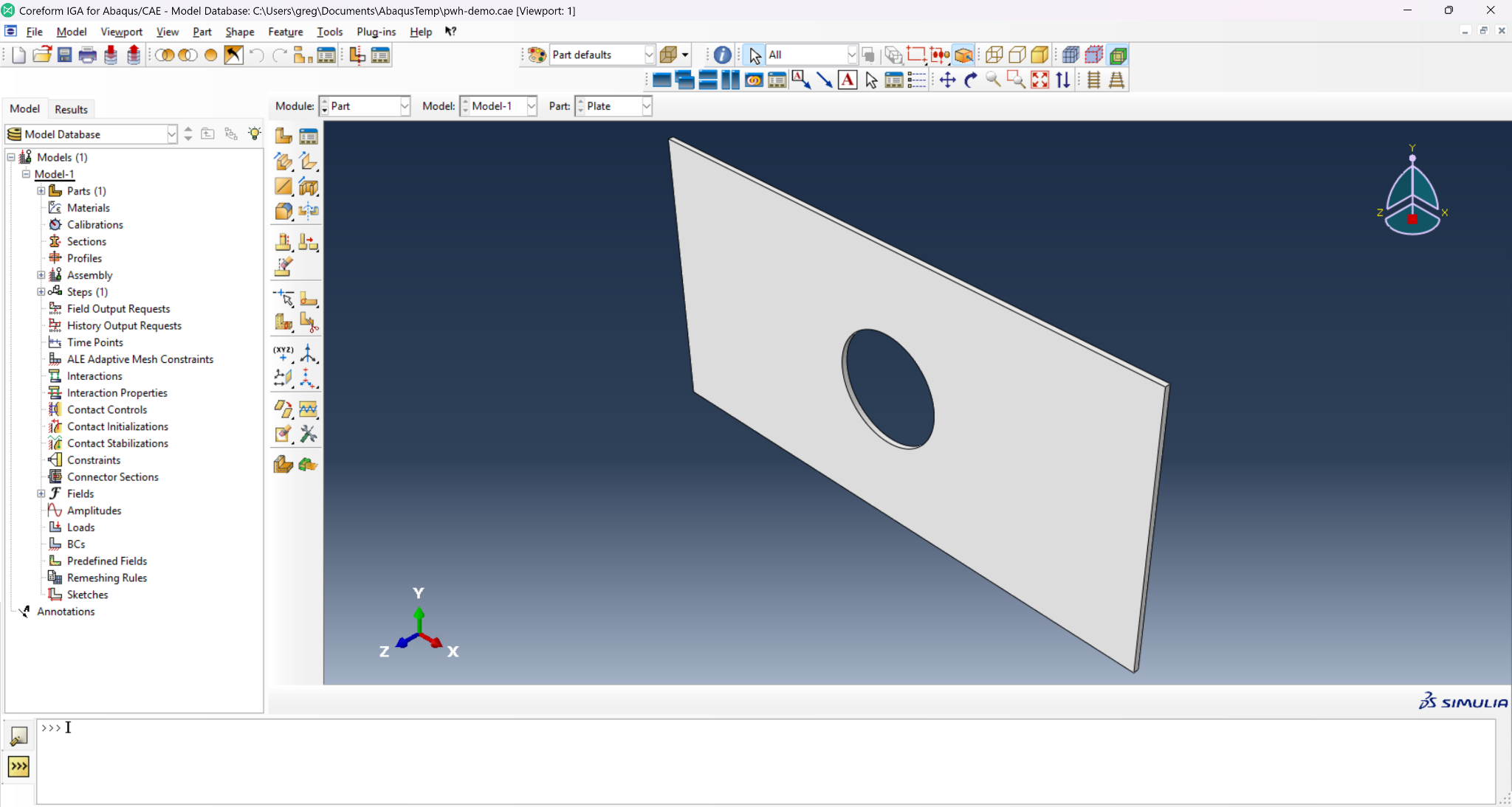

The sketch is now fully-defined and fully-constrained — it is finished! We now want to click on the Done button next to the viewport prompt of Sketch the section for the solid extrusion. If you do not see that prompt, carefully click on the Cancel icons until you do.

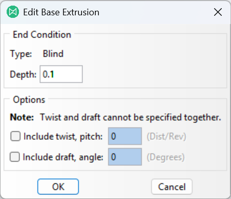

You should now see the Edit Base Extrusion dialog box which will prompt you to provide the extrusion depth, which should be 0.1. After entering this value, click the OK button.
You should now see a solid geometry rendered within the viewport, similar to that shown in the following image:
This concludes the Part module portion of the workflow.

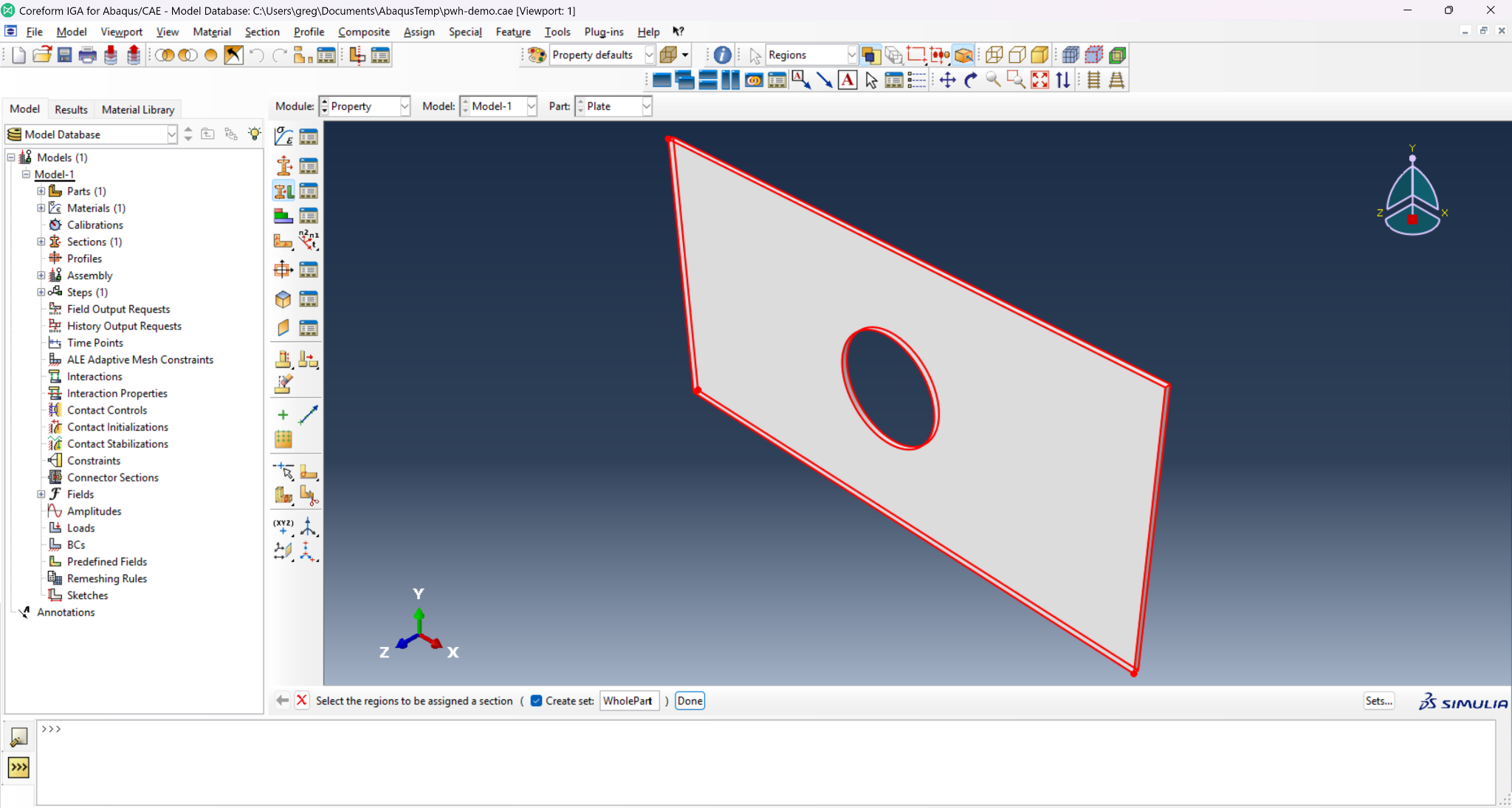

2.3 Property module

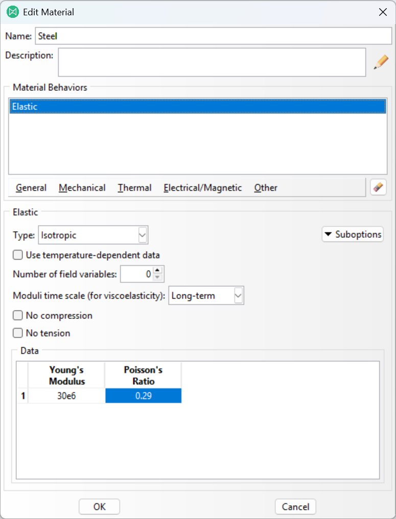

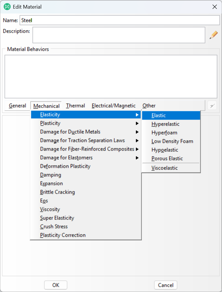

Click on the Create Material icon to open the Create Material dialog to create a new material called Steel. Since we will be performing a static analysis we do not need to provide a mass density, but do need to provide the isotropic elastic moduli from the table below. The values are also visible in the Edit Material screenshot below.
Material Property Value Units
Young’s Modulus \(30 \times 10^6\) \(\text{lbf}/\text{in}^2\)
Poisson’s Ratio \(0.29\) –
After entering these values, click the OK button.

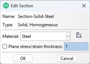

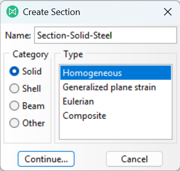

Next, click on the Create Section icon to open the Create Section dialog to create a new section, named Section-Solid-Steel. The category of section should be Solid and the Type should be Homogeneous, as demonstrated in the image below.
After entering these values, click the Continue button.
At the Edit Section dialog box choose the Steel material within the Material selection dialog.
Then click the OK button.

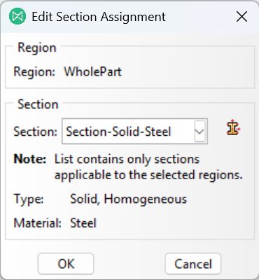

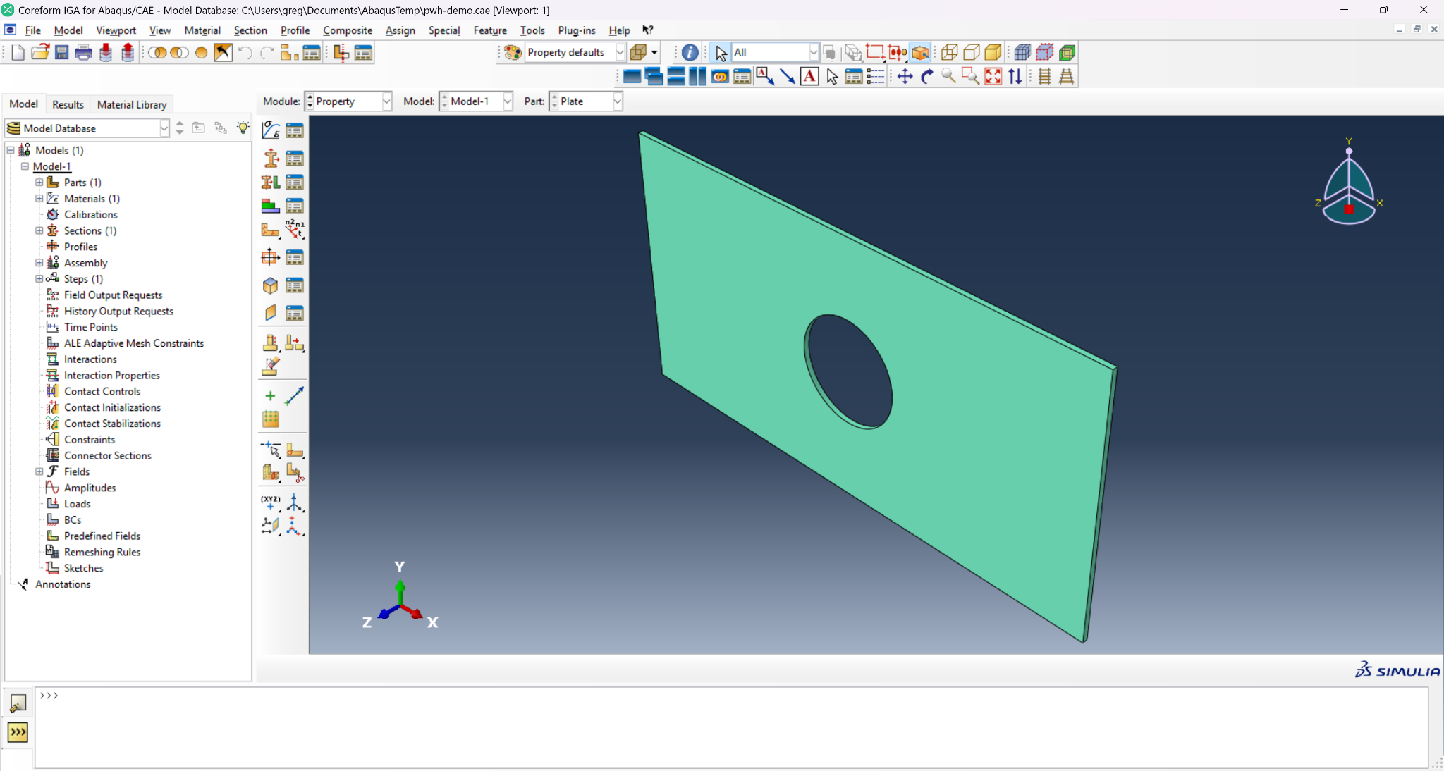

Next, click on the Assign Section icon to assign the Section-Solid-Steel to the entire part. This will prompt you to make a region selection within the viewport and will provide you with the option to create a named set for the selected region. We recommend naming this set WholePart, though you may choose any name or even unselect the Create set option to avoid creating a set1.
At the Edit Section Assignment dialog box choose the Section-Solid-Steel section within the Section selection dialog.
Then click the OK button. The part should now be colored green, signifying that a section has been properly assigned.
This concludes the Property module portion of the workflow.

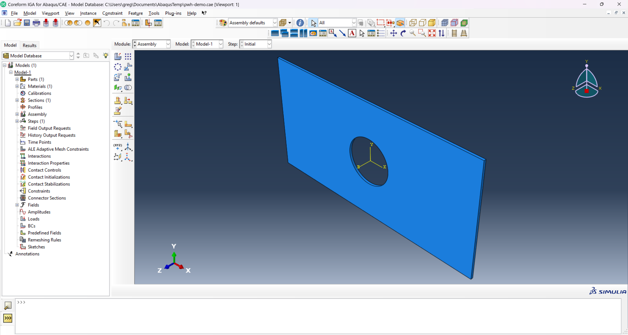

2.4 Assembly module

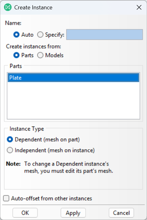

Click on the Create Instance icon to open the Create Instance dialog to create a new instance. Select the Plate part as the entity to instance in the assembly, keeping the default Dependent (mesh on part) option for the Instance Type option.
Then click the OK button to generate the instance. You should now see an instance of the part, colored blue, in the viewport.

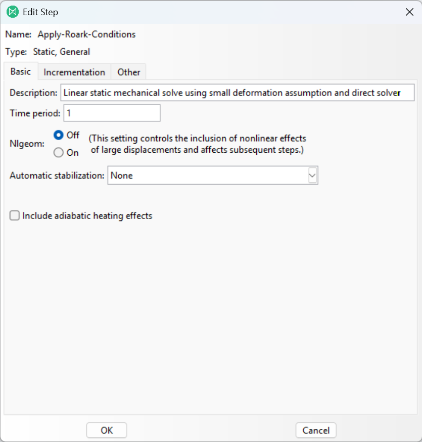

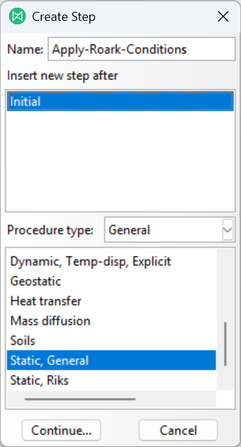

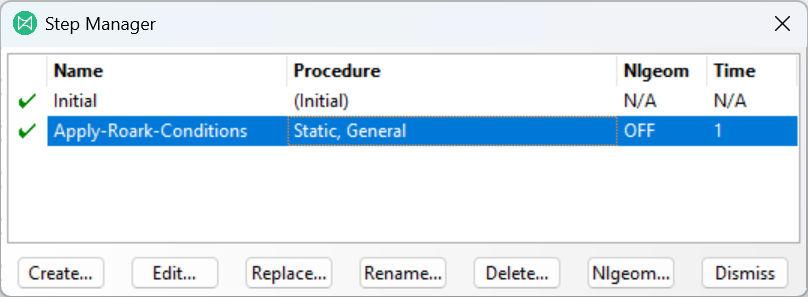

Click on the Create Step icon to open the Create Step dialog to create a new step. Name our new step Apply-Roark-Conditions, make sure the General procedure type is selected in the selection-box, and then choose Static, General from the list of available procedures as demonstrated in the following image.
Clicking the Continue button should then display the Edit Step dialog box. We can keep the default settings, which notably will have a (pseudo)time period of 1.0, will use the small deformation assumption (Nlgeom=off), and use direct equation solvers (under the Other tab). If you’d like to provide a description, you may, but this is not required.
Then click the OK button to complete creating the step. If you click the Step Manager icon to the right of the Create Step icon, you should see our new step listed with a green checkmark () next to it as shown in the image below.

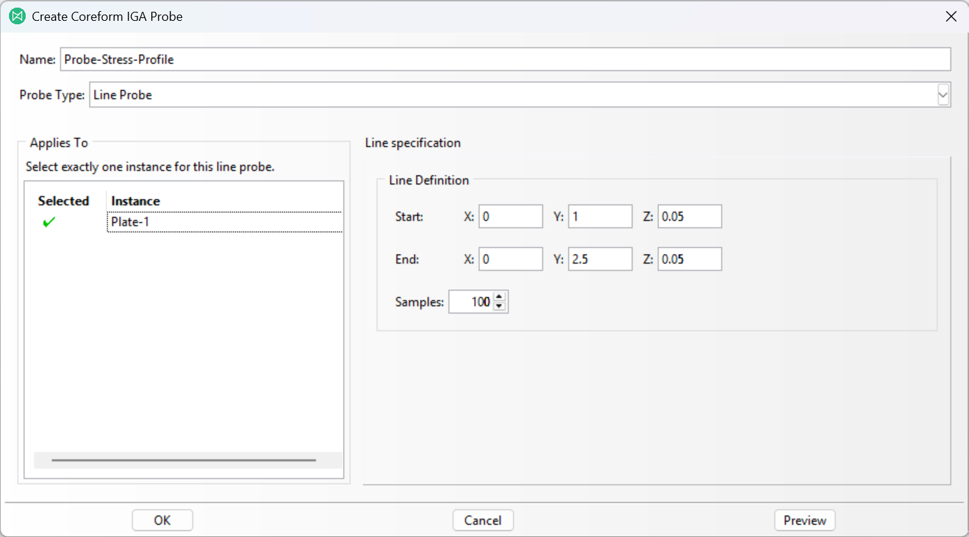

In this example, we will create a Line Probe along the mid-thickness of the plate, whose origin is the radius of the hole along the Y-axis and which extends along the Y-axis to the outer surface of the plate. To create the Coreform IGA Probe click on the Create Coreform IGA Probes icon and then set the parameter-value pairs as shown in the table and image below:
Parameter Value
Name Probe-Stress-Profile
Probe Type Line Probe
Instance Plate-1
Start (X, Y, Z) (0, 1, 0.05)
End (X, Y, Z) (0, 2.5, 0.05)
Num Points 100
Then click the OK button to complete the creation of the Coreform IGA Probe.

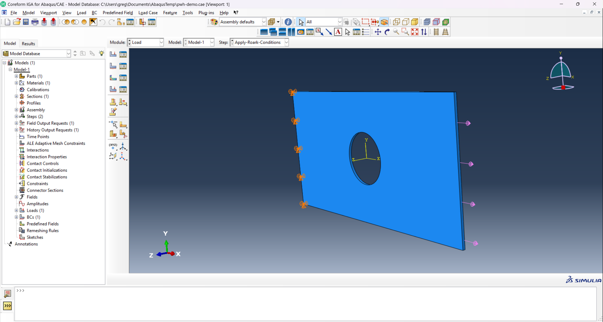

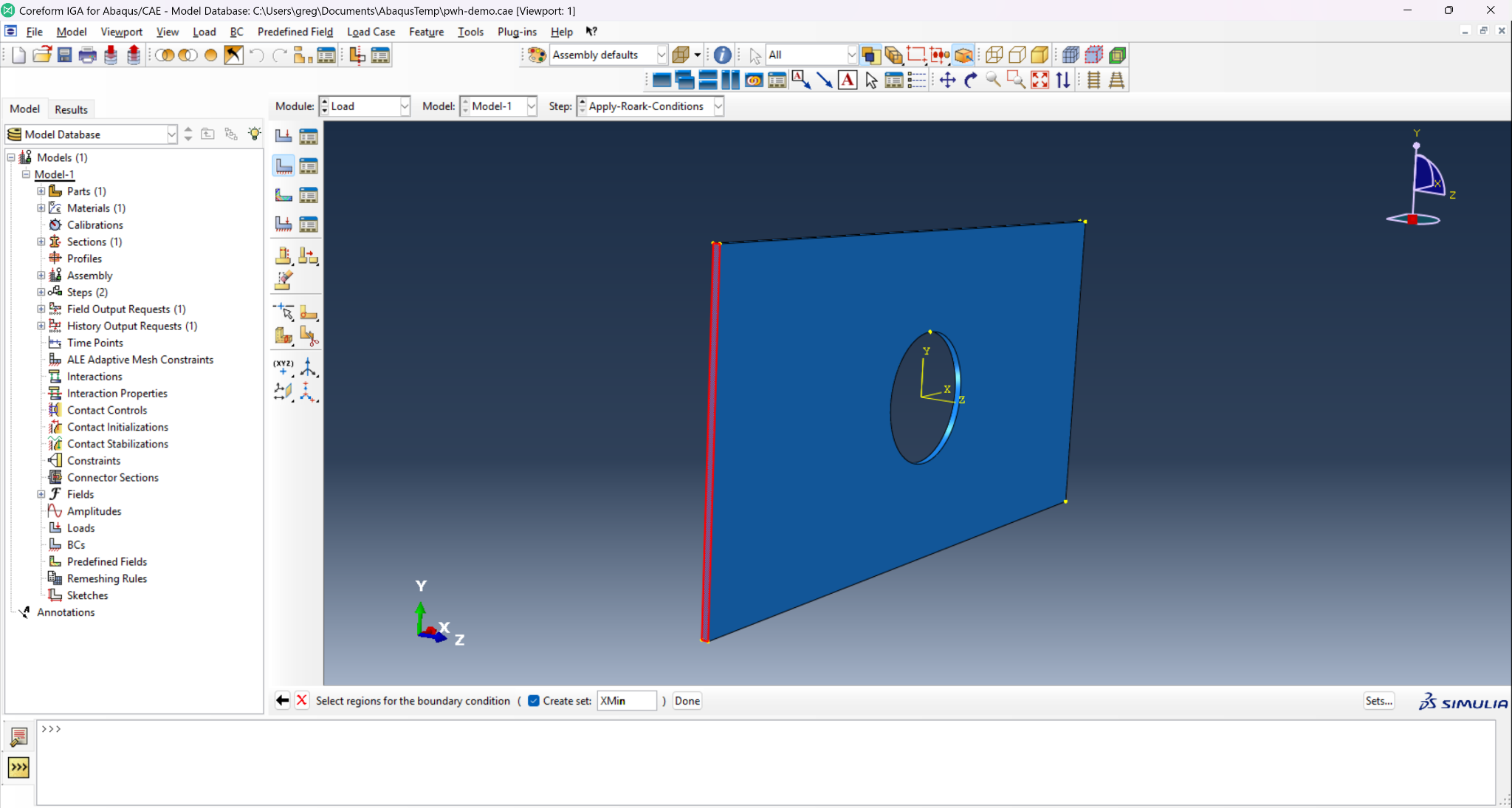

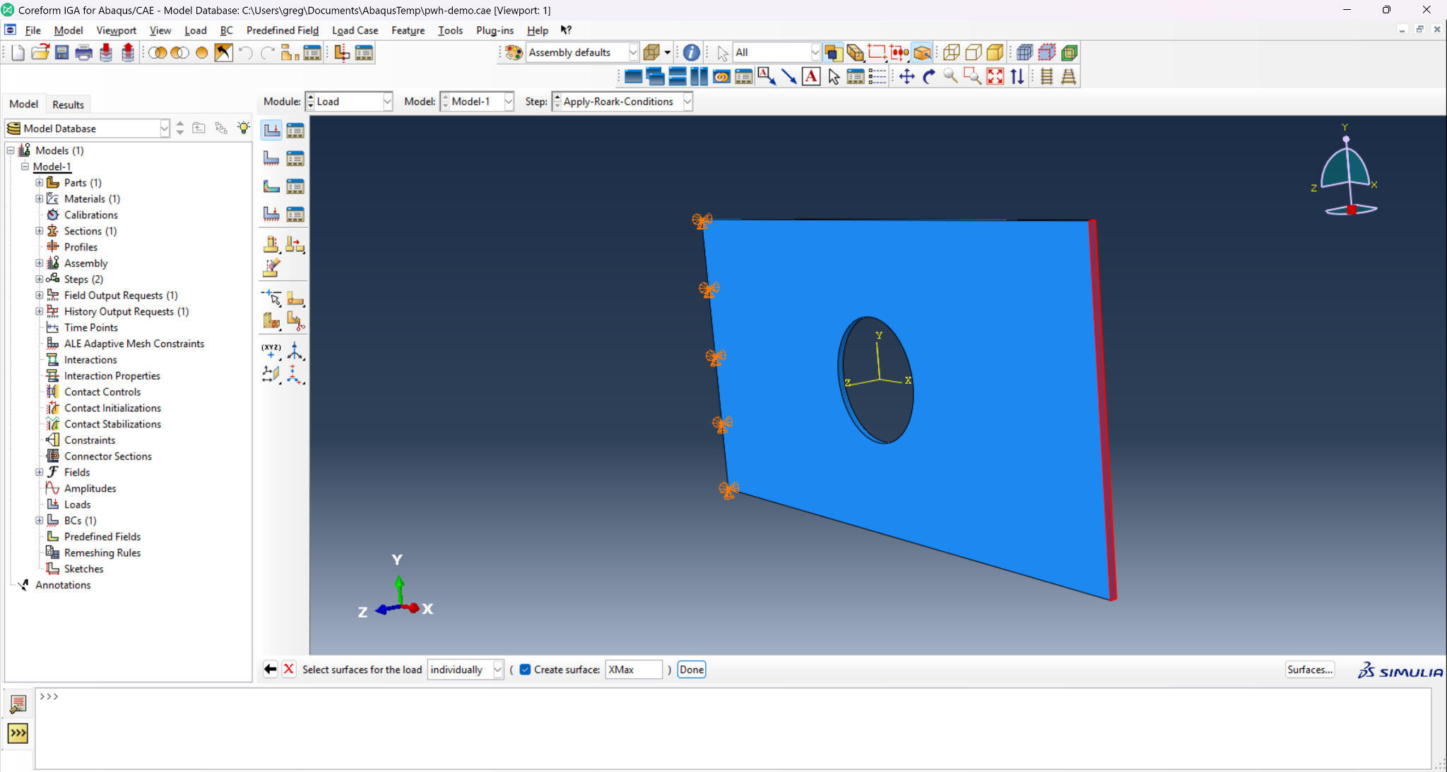

2.7 Load module

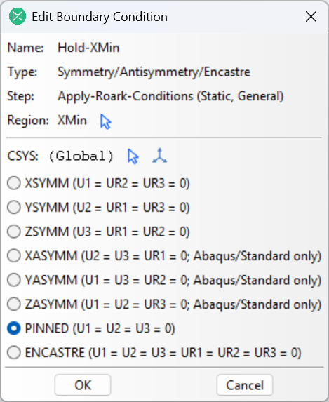

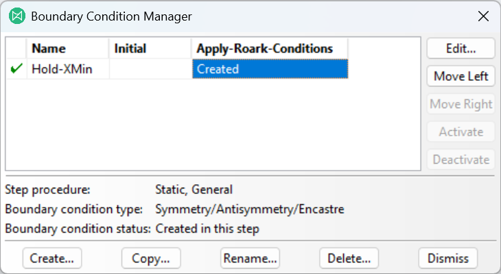

This problem utilizes a pinned displacement boundary condition on the X-minimum surface4. It also uses a small, uniformly-distributed negative pressure on the X-maximum surface5, with the pressure pointing outwards from the geometry’s interior so as to place the plate in tension.
2.7.1 Pinned displacement boundary condition

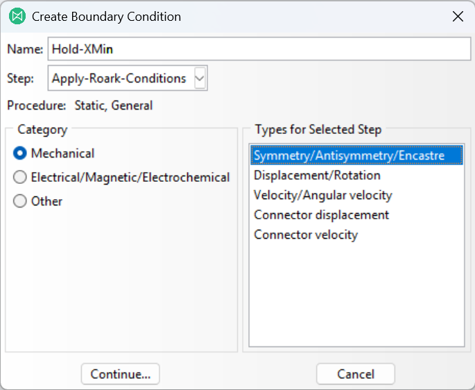

Click on the Create Boundary Condition icon to open the Create Boundary Condition dialog to create a new boundary condition with the name Hold-XMin. In the Step selection box, be sure that our Apply-Roark-Conditions step is selected, then choose the Mechanical category and Symmetry/Antisymmetry/Encastre as the type.
Then click the Continue button.
The viewport should now prompt you to select the regions for the boundary condition; select the X-minimum surface as described earlier. We recommend creating a set with the name XMin.
Then click the Done button.
In the Edit Boundary Condition dialog box choose the PINNED option, which will enforce zero-displacement on the surface.
Then click the OK button to complete creating the boundary condition. If you click the Boundary Condition Manager icon to the right of the Create Boundary Condition icon, you should see our new boundary condition listed with a green checkmark () next to it as shown in the image below.
You should also see a rendering of the boundary condition within the viewport, denoting the surface and degrees-of-freedom (DOFs) that are constrained.

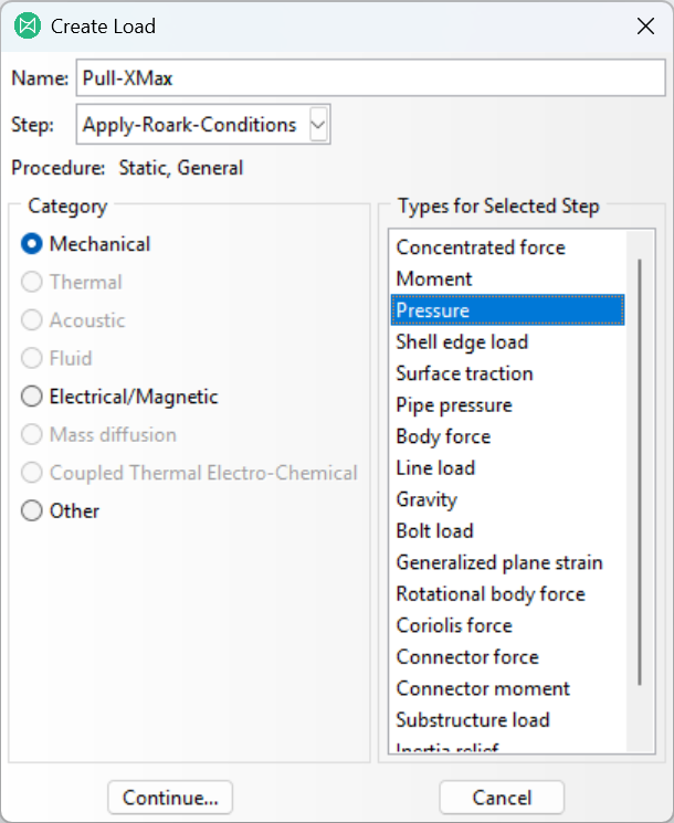

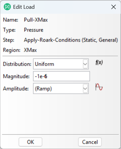

2.7.2 Pressure load condition
Click on the Create Load Condition icon to open the Create Load Condition dialog to create a new load condition with the name Pull-XMax. In the Step selection box, be sure that our Apply-Roark-Conditions step is selected, then choose the Mechanical category and Pressure as the type.
The viewport should now prompt you to select the regions for the load condition; select the X-maximum surface as described earlier. We recommend creating a set with the name XMax.
In the Edit Load dialog box, set the parameter-value pairs as shown in the table and image below:
Parameter Value
Distribution Uniform
Magnitude -1e-6
Amplitude (Ramp)
Then click the OK button to complete creating the load condition.
You should see an updated rendering of the previously-assigned boundary condition and now the pressure load condition within the viewport. Verify that the vectors representing the pressure condition are pointing away from the surface (i.e., in the +X direction). If they are pointing into the surface (i.e., in the -X direction) then you likely forgot the - sign in the magnitude field.
This concludes the Load module portion of the workflow.

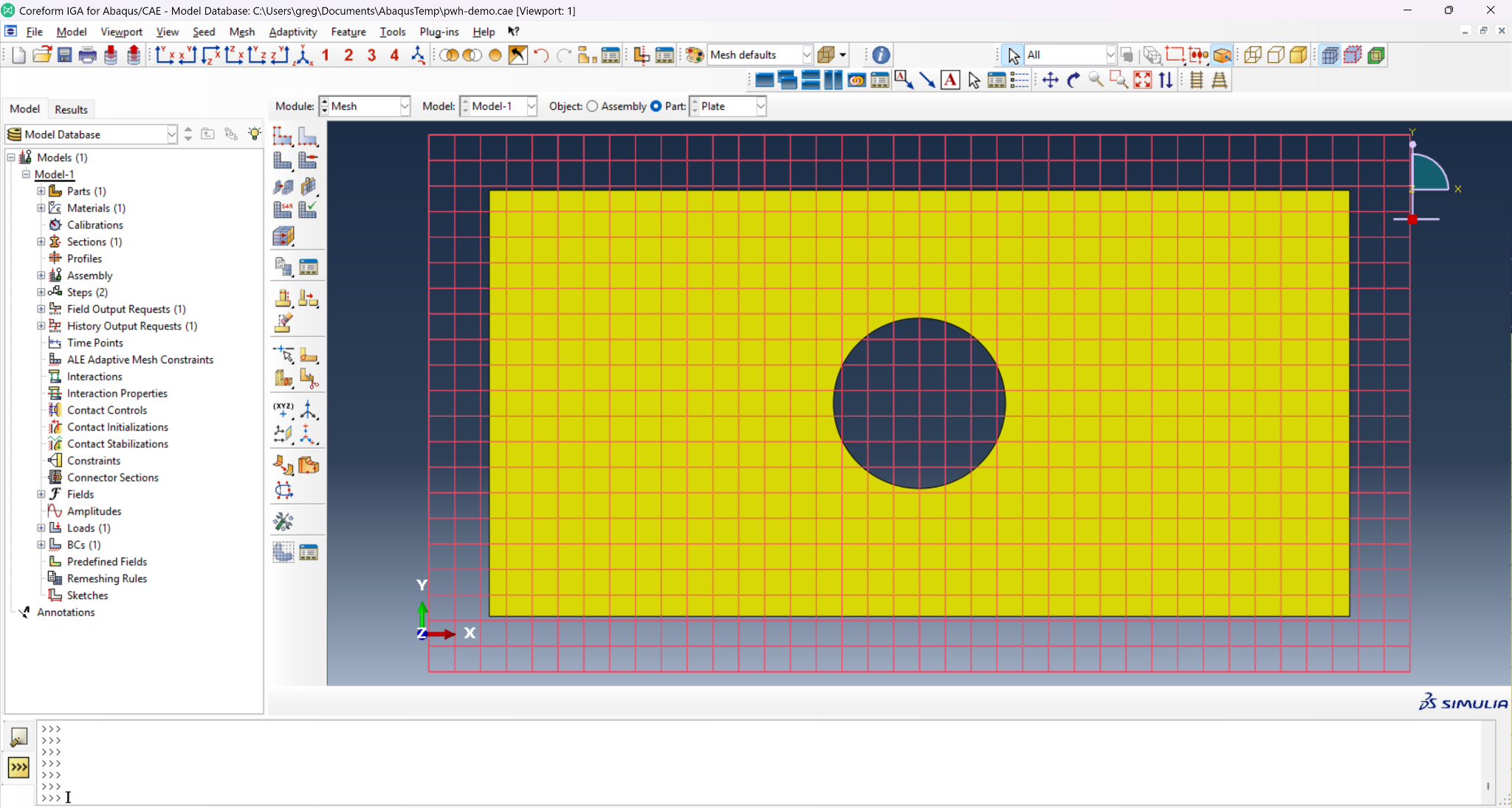

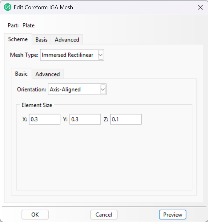

2.8 Mesh module

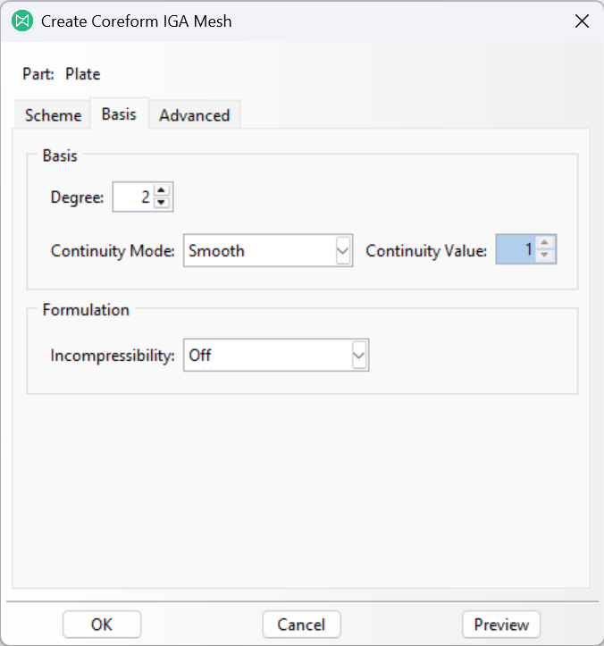

To create the Coreform IGA Mesh select Part as the active Object at the top of the viewport.
This should then show a rendering of the plate, colored yellow as shown below.
Next click on the Create Coreform IGA Meshes icon in the taskpane.
In the Create Coreform IGA Mesh dialog box, ensure that the following parameter-value pairs are set as shown in the table and image below:
Parameter Value
Mesh Type Immersed Rectilinear
Element Size (0.3, 0.3, 0.1)
Degree 2
Continuity Mode Smooth
And then click the OK button.
You should now see a red mesh that envelopes the plate geometry as shown in the image below.
You can toggle visibility of this mesh by clicking the Show Native Mesh icon .

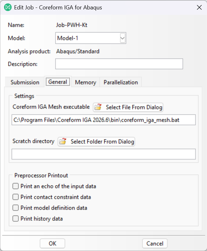

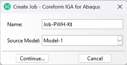

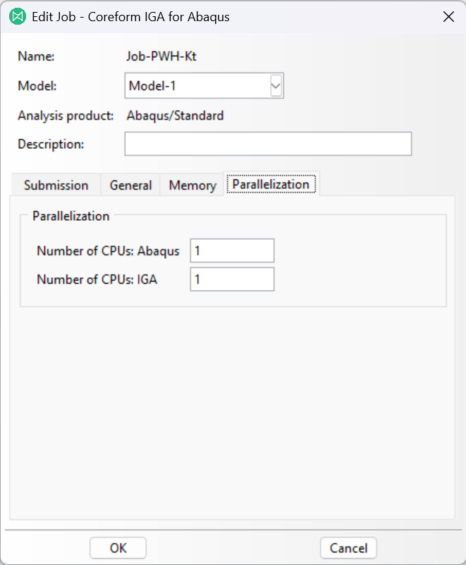

2.9 Job module
To create and run a Coreform IGA for Abaqus simulation click on the Create Coreform IGA Job icon and provide the name Job-PWH-Kt in the dialog box, then click the Continue button.
In the Edit Job - Coreform IGA for Abaqus dialog box make sure the correct Coreform IGA Mesh executable is selected. Finally, you can control the parallelization of both Coreform IGA Mesh and the Abaqus solver by entering the desired amount of CPUs for each — they do not have to be equal to each other. However, this simulation is small enough that one CPU for each process is fine.

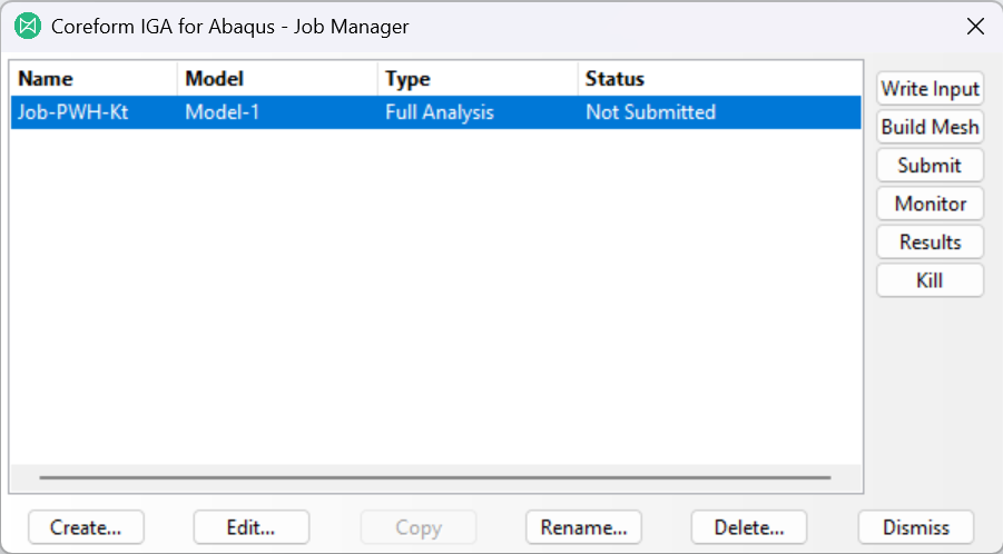

Next click on the Coreform IGA Job Manager icon to open the Coreform IGA for Abaqus Job Manager, select the job we just created, and click the Submit button to run the job.
If the job runs successfully, you should see the following text printed in the Message Area of Abaqus/CAE:
Job Job-PWH-Kt: Analysis Input File Processor completed successfully.
Job Job-PWH-Kt: Abaqus/Standard completed successfully.
Job Job-PWH-Kt completed successfully.

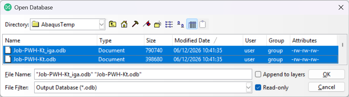

When the job completes successfully, open the two ODB files generated by the solve.

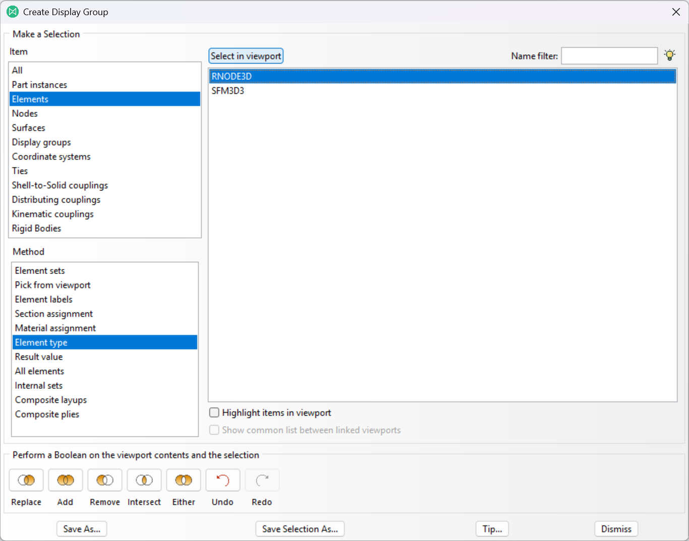

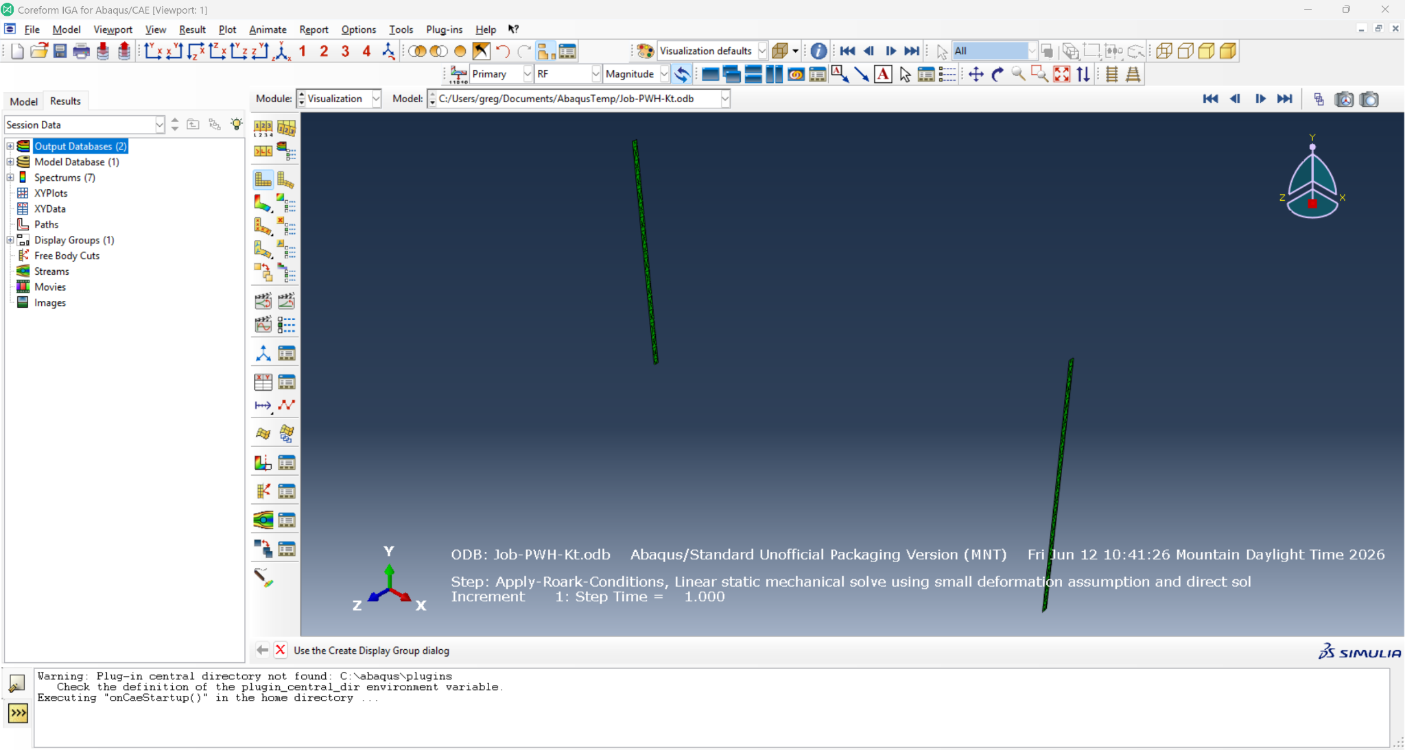

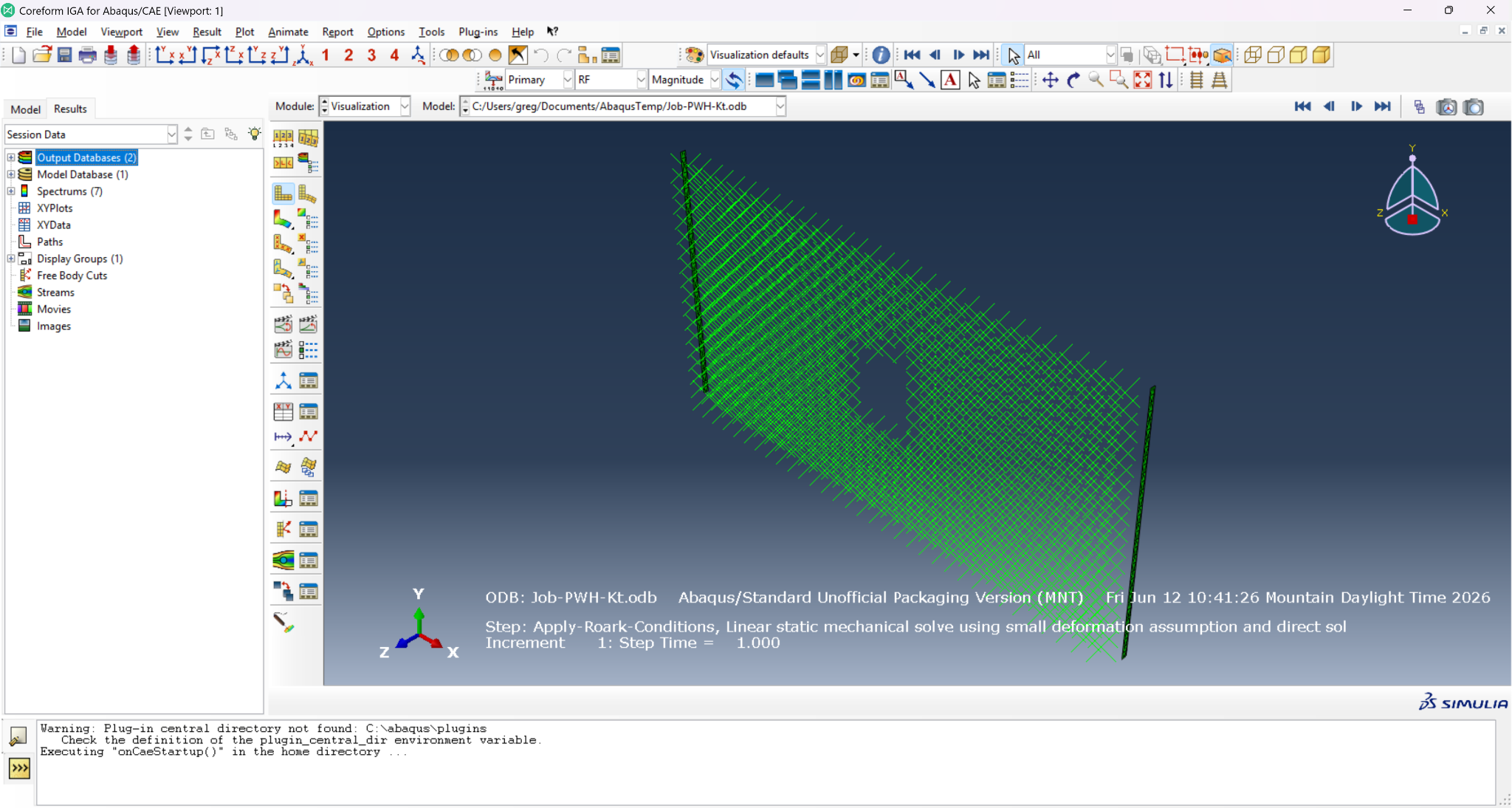

Rendering the Abaqus ODB file should show two triangle meshes where the XMin and XMax sets were defined, and a bunch of ✕ markers representing the user elements.
We recommend clicking on the Create Display Group icon to open the Create Display Group dialog box, selecting the RNODE3D element types, and then clicking the Remove icon to remove these user-element markers.
You can then click the Dismiss button to close the dialog.
These surfaces correspond to surfaces selected in our boundary and load conditions.

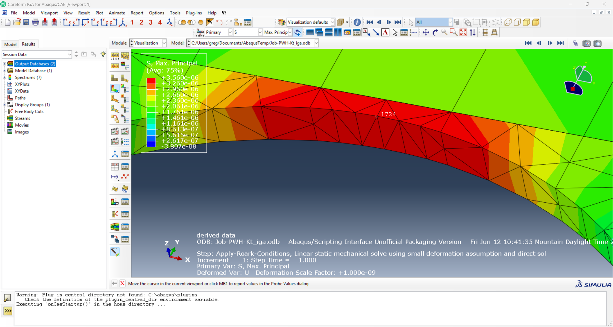

2.10.2 Working with the IGA ODB file

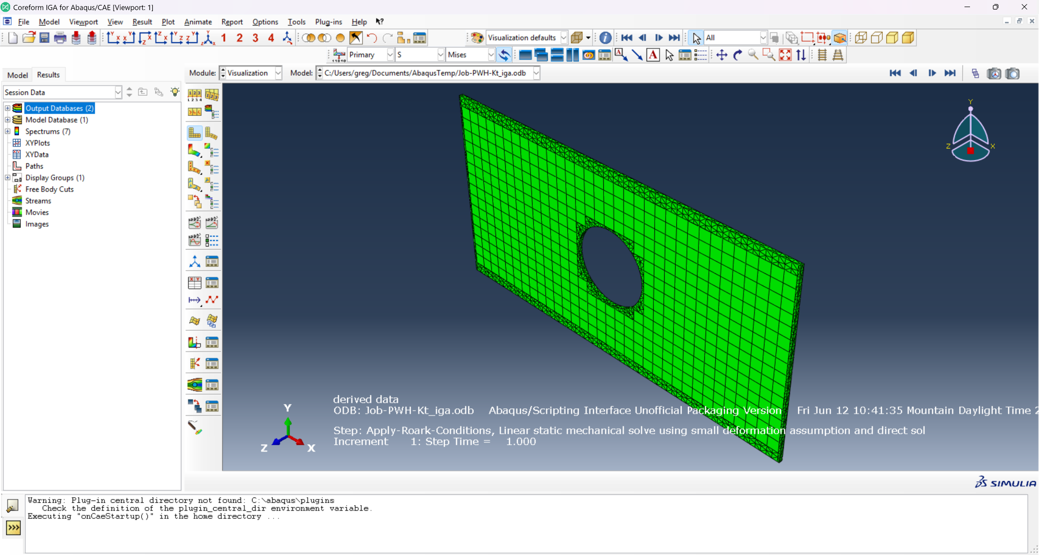

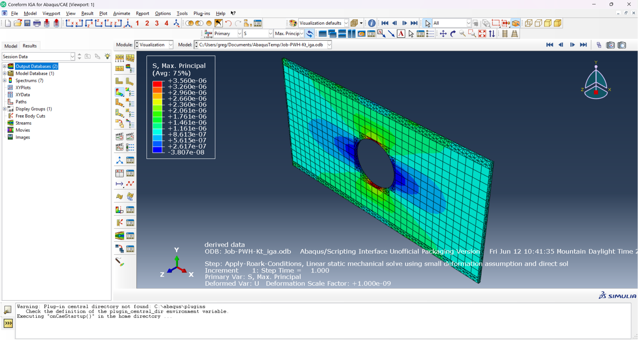

Switching to the IGA ODB file we are presented with an output mesh approximation of the solution geometry, as a workaround to user elements not being supported by Abaqus/CAE for visualization. Untrimmed elements are represented by C3D8 elements and trimmed elements are meshed with C3D4 elements.

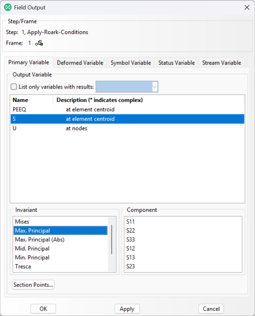

We can generate a contour plot of the maximum principal stress, which is the stress invariant that we care about as far as stress concentrations are concerned, by clicking the Plot Contours on Deformed Shape icon in the taskpane, and then clicking on the Field Output Dialog in the toolbar. In the Field Output dialog box, select S as the Output Variable and Max. Principal as the Invariant as shown in the image below.
The viewport should now display the simulation results, colored by maximum principal stress, and with our output mesh rendered. There should also be a legend that displays the maximum principal stress value anywhere in the model.

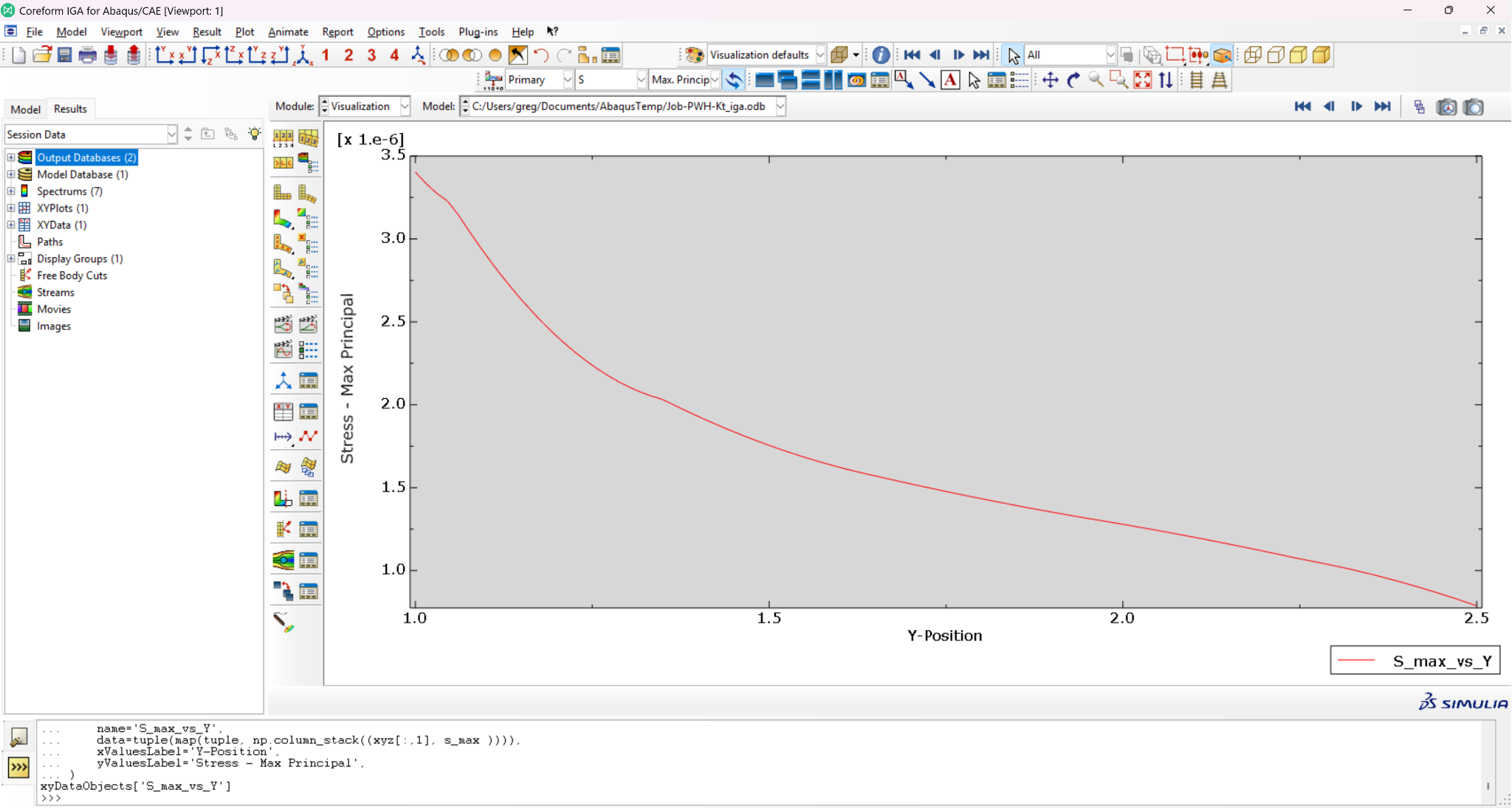

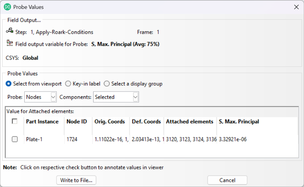

We can also use Abaqus/CAE’s probe functionality by navigating our view so that we’re looking at the expected location of the stress concentration and then clicking on the Probe values icon in the taskpane.
In the Probe Values dialog box select the Nodes item in the Probe field. Then in the viewport, select the node closest to our expected maximum stress location.
This should then populate a row within the Probe Values dialog box that lists the maximum principal stress associated with that node:

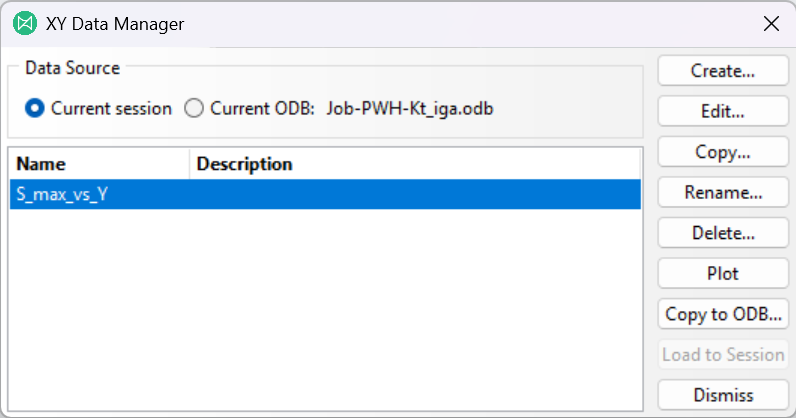

Finally, we can also open the probe_data.json file using Python in the Kernel Command Line Interface to extract the stress components and compute the maximum principal stress. The current probe schema groups samples by contributing IGA part or leaf. The source_location_indices values map those group-local samples back to the requested line-probe locations. The script below gathers every final-frame sample, restores that order, and retains multiple values if more than one leaf contributes at a boundary.
import json
import os
import numpy as np
job_dir = r"C:\Users\Owner\Documents\AbaqusTemp\CoreformIGA\ExampleProblems\PWH-Kt\JobDir"
probe_filename = os.path.join(job_dir, "probe_data.json")
with open(probe_filename) as probe_file:
    probe_data = json.load(probe_file)
stress_probe = probe_data[
    "Apply-Roark-Conditions"
]["history"]["Probe-Stress-Profile"]
components = ("XX", "YY", "ZZ", "XY", "XZ", "YZ")
samples = []
for group in stress_probe["part_groups"]:
    source_indices = group["source_location_indices"]
    locations = group["locations"]
    stress = group["Stress"]
    component_values = [stress[name][-1] for name in components]
    expected_count = len(source_indices)
    if len(locations) != expected_count or any(
        len(values) != expected_count for values in component_values
        raise ValueError("probe locations and final stress values are misaligned")
    for slot, (source_index, location) in enumerate(

hole_edge_values = s_max[source_indices == 0]
if not hole_edge_values.size:
    raise ValueError("probe has no sample at requested source location 0")
hole_edge_stress = np.max(hole_edge_values)
print("Maximum principal stress at the hole edge:", hole_edge_stress)
We compute the accepted maximum principal stress using the net-section stress-concentration factor from Roark, Table 17.1, case 7a [1]. Here \(D\) is the plate width, \(r\) is the hole radius, \(t\) is the plate thickness, \(P\) is the applied pressure magnitude, and \(A = Dt\) is the loaded end-face area.
\[ K_t = 3.00 - 3.13\left(\frac{2r}{D}\right) + 3.66\left(\frac{2r}{D}\right)^2 - 1.53\left(\frac{2r}{D}\right)^3 \]
\[ \sigma_\text{nom} = \frac{F}{t\left(D - 2r\right)} = \frac{PA}{t\left(D - 2r\right)} \]
\[ \sigma_\text{max} = K_t \, \sigma_\text{nom} \]
Evaluating these equations for the example dimensions and load gives \(2r/D = 0.4\), \(K_t = 2.23568\), \(F = 5.0000 \times 10^{-7}\,\text{lbf}\), \(\sigma_\text{nom} = 1.6667 \times 10^{-6}\,\text{lbf}/\text{in}^2\), and \(\sigma_\text{max} = 3.7261 \times 10^{-6}\,\text{lbf}/\text{in}^2\).
The comparison below combines the analytic calculation with the numerical observations captured for this walkthrough.
Table 1: Captured walkthrough observations compared with the accepted Roark value.
Method Maximum principal stress [lbf/in²] Difference from Roark
Roark (accepted) \(3.7261 \times 10^{-6}\) —
Proxy ODB nodal probe \(3.3292 \times 10^{-6}\) \(-10.7\%\)
IGA solver probe \(3.4031 \times 10^{-6}\) \(-8.7\%\)
Note
Numerical values reported by the documentation may be refreshed more often than the static Abaqus/CAE screenshots used to illustrate the workflow. Small differences can therefore appear between a reported value and the value shown in a screenshot. For your analysis, use the postprocessing code above with the probe_data.json generated by your run.
We can also plot the maximum principal stress along our probe by creating an XYData object in the following manner:
session.XYData(
    name="S_max_vs_Y",
    data=tuple(map(tuple, np.column_stack((xyz[:, 1], s_max)))),
    xValuesLabel="Y position",
    yValuesLabel="Maximum principal stress",
Then click on the XY Data Manager icon to open the XY Data Manager dialog, select the S_max_vs_Y data that we just created, and click the Plot button.
The viewport should now contain a line plot of the probe, similar to the image shown below.
This concludes the Visualization module portion of the workflow.
