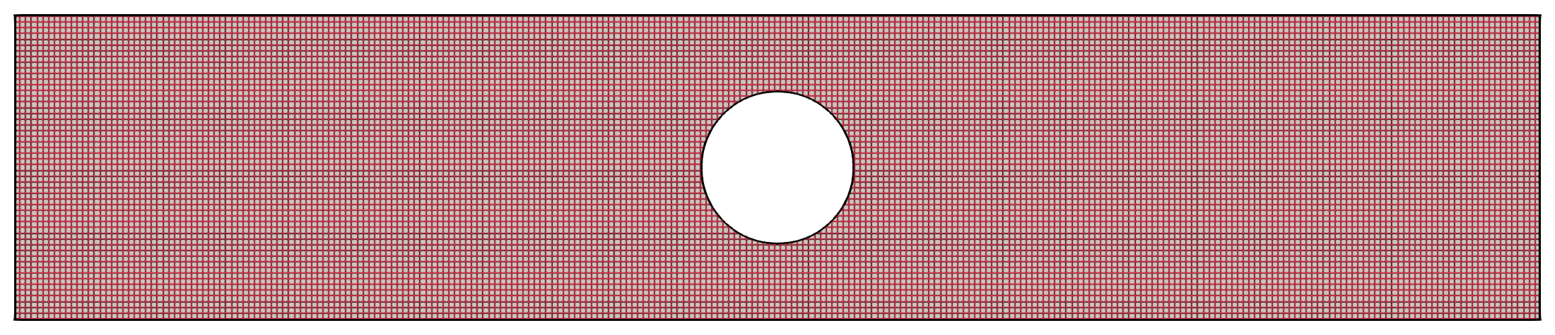

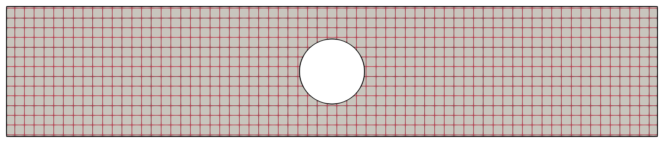

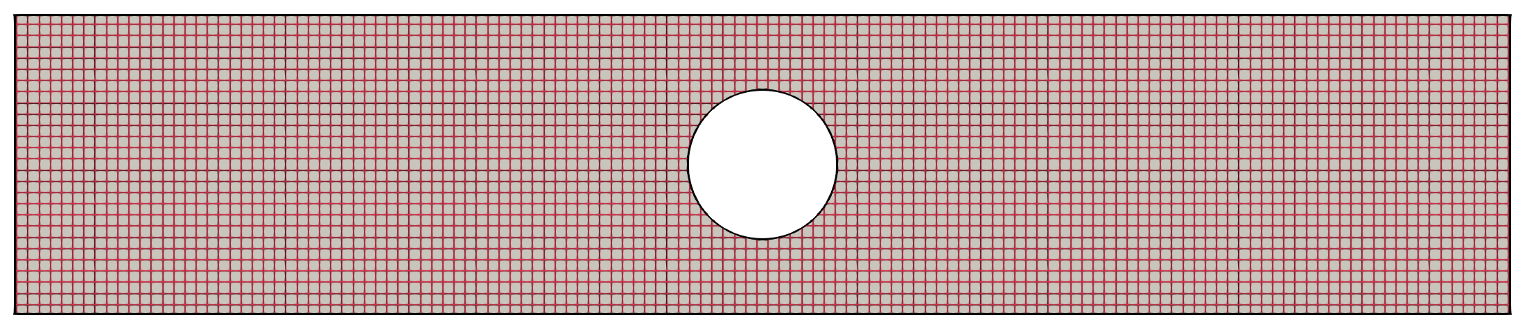

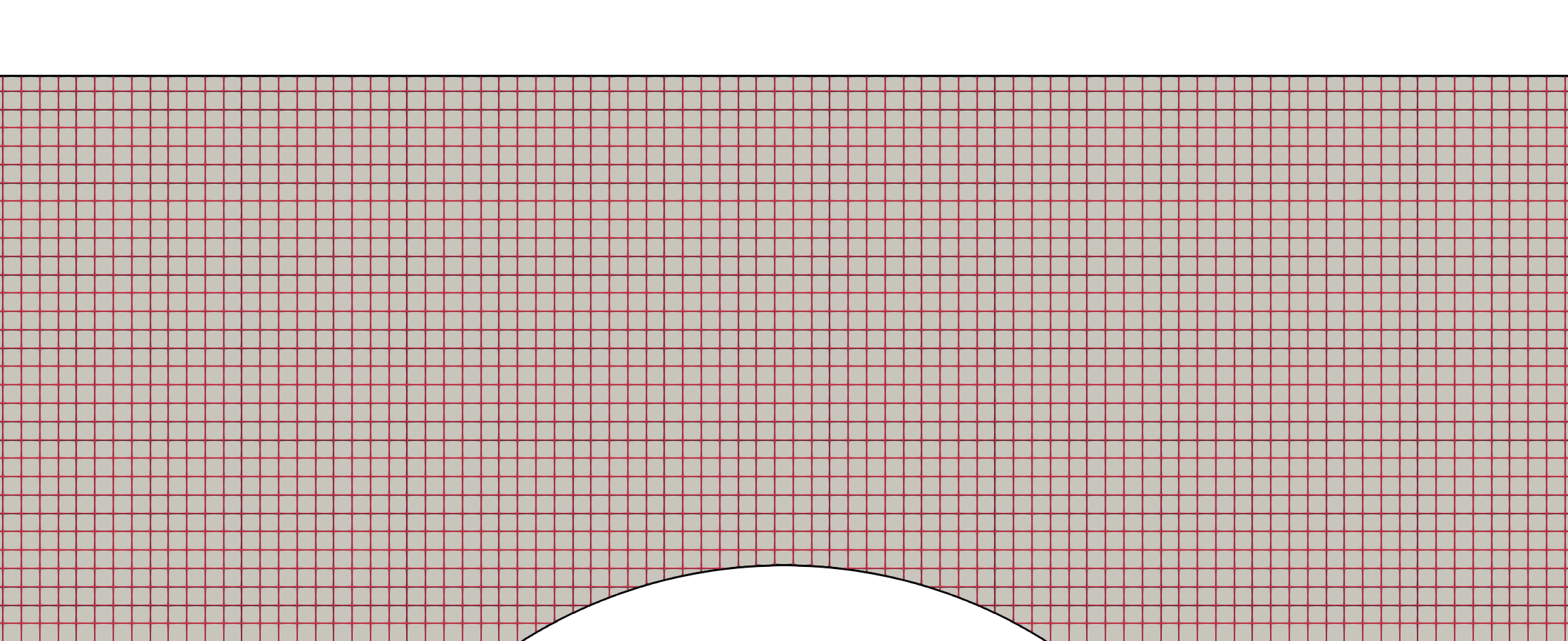

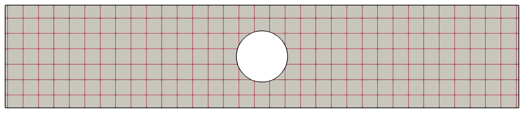

5 Mesh & discretization
Coreform IGA discretizes the coupon with immersed, trimmed U-splines: a structured background spline is trimmed to the coupon-with-hole geometry rather than body-fitting a mesh to it. We run an \(h/p\) refinement study — background element size \(h = 6/2^{k}\) for \(k = 0,\dots,4\) at polynomial degrees \(p = 1\), \(2\), and \(3\). A separate local-refinement sweep (Section 7.6) keeps the \(h = 3\), \(p = 2\) background and refines only around the hole. Per-mesh element, node, and degree-of-freedom counts are reported in Section 8.

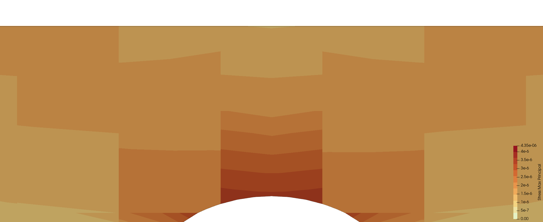

The tabs below show the trimmed immersed mesh at each background element size \(h\) (the mesh is shared by all degrees \(p\)), rendered from the run’s IGA results database: trimmed Bezier element edges (carnation) on the CAD surface, CAD edges in black. The Reference tab shows the body-fitted Abaqus mesh, rendered from the VTU the reference test exports. The first group views the full coupon; the second is a detail of the nominal section, from the top of the hole to the top of the coupon.
Full coupon
Nominal-section detail

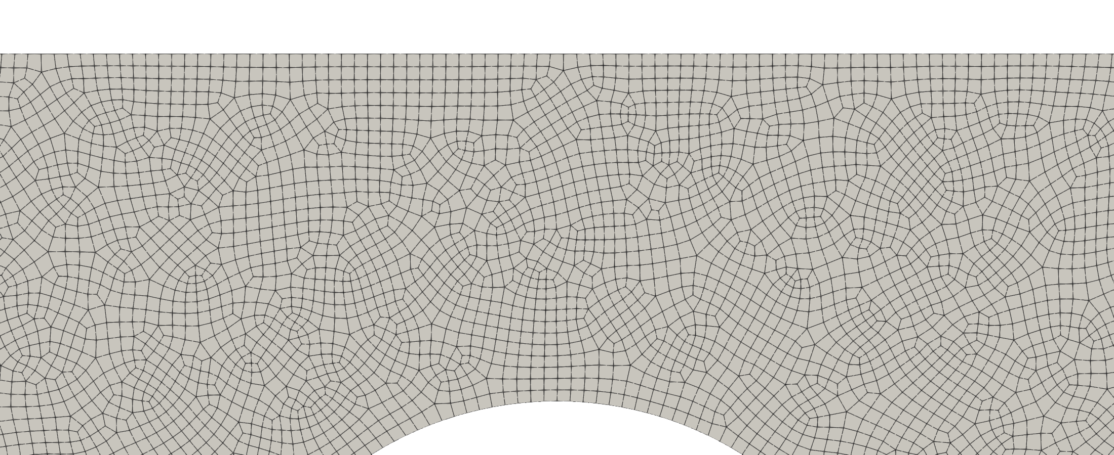

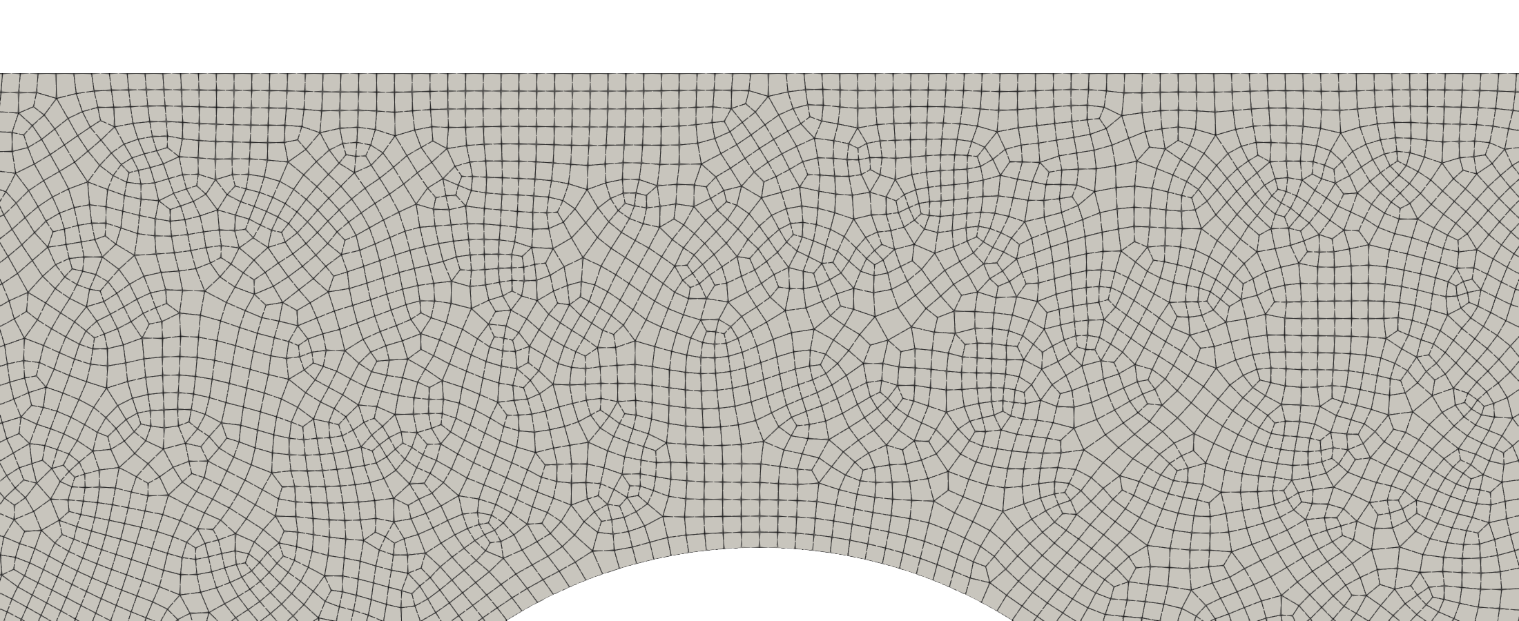

The reference solution is a normal Abaqus analysis of the same coupon using a dense, body-fitted mesh of quadratic elements. Its transverse stress and displacement profiles along the line probe are the comparison for the field quantities, and its peak max-principal stress at the hole edge provides an independent numerical estimate to sit alongside Roark’s accepted value (Table 5). Being itself a numerical approximation rather than the exact solution, the reference is not treated as ground truth — a distinction that matters for the convergence study (Section 7.5).

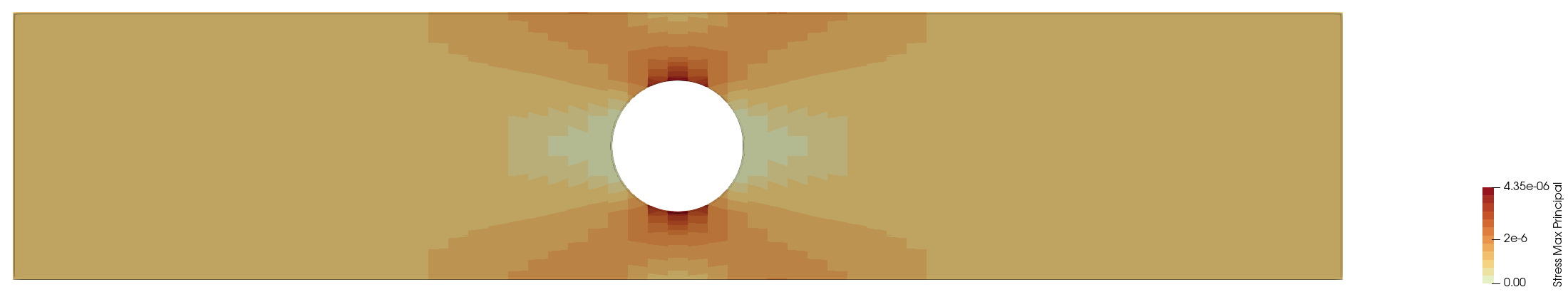

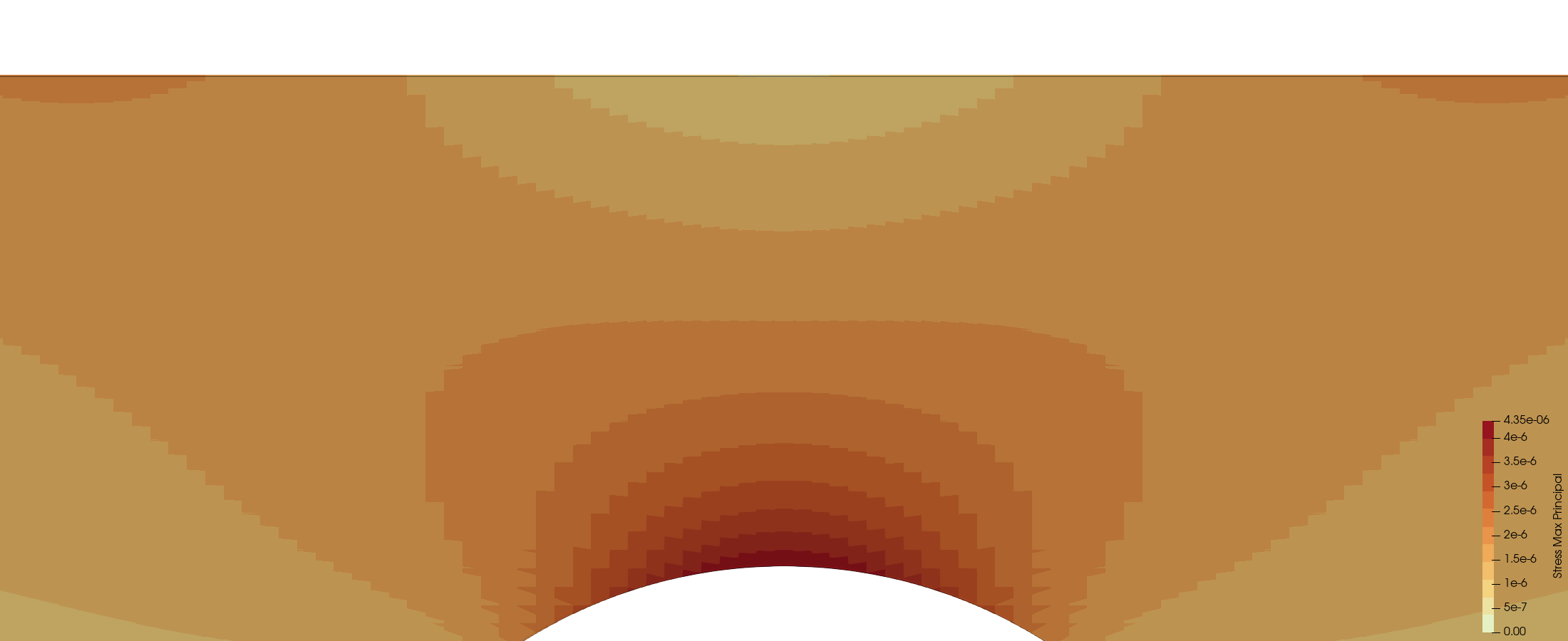

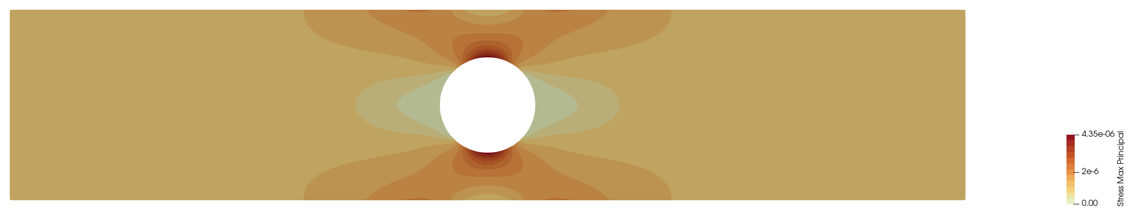

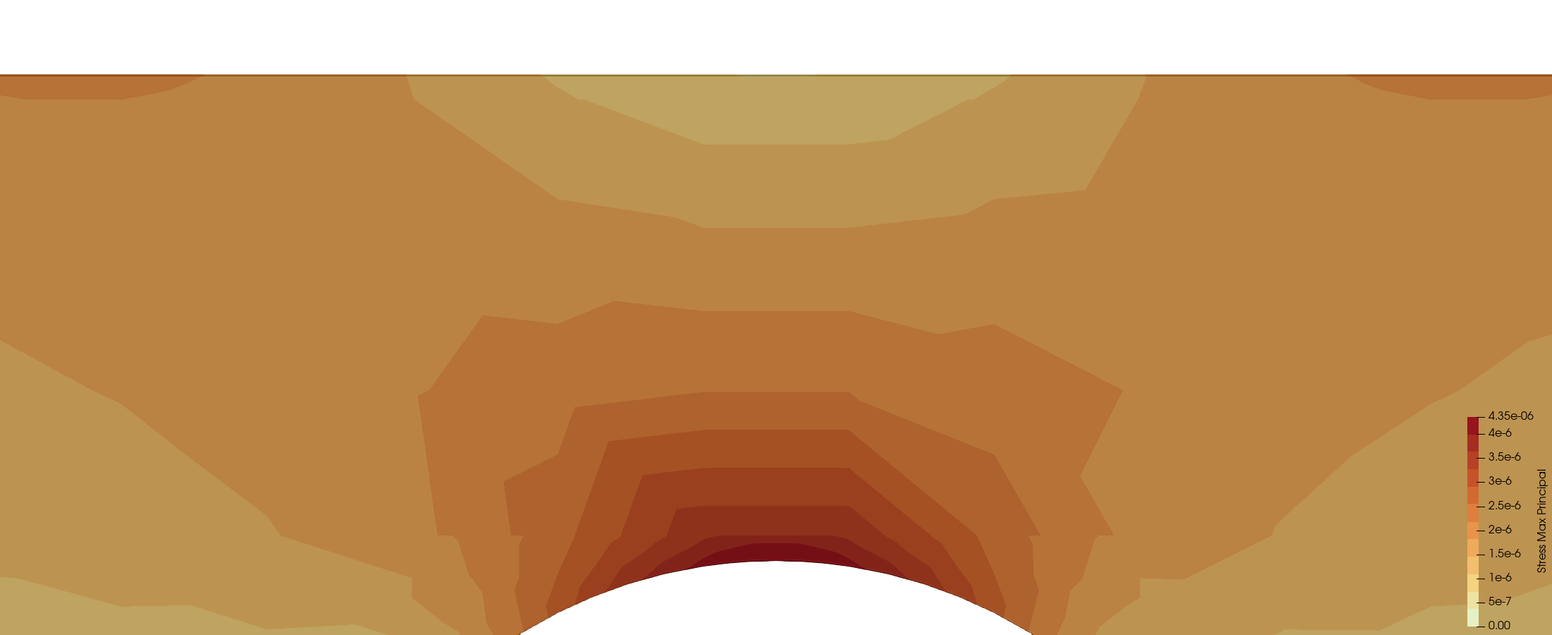

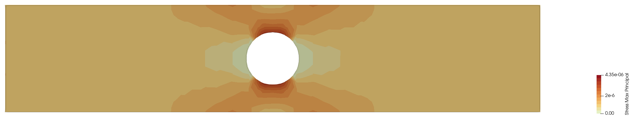

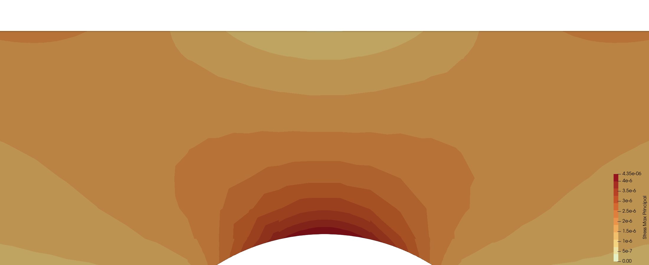

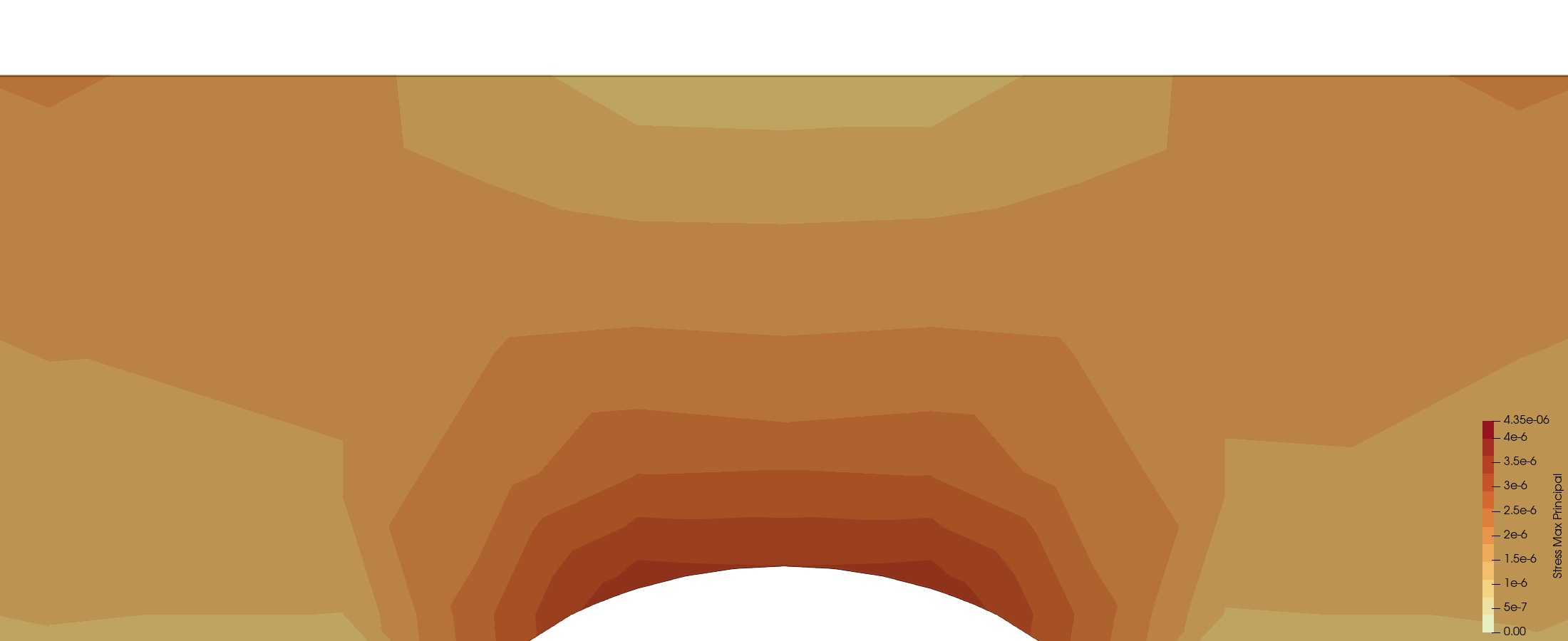

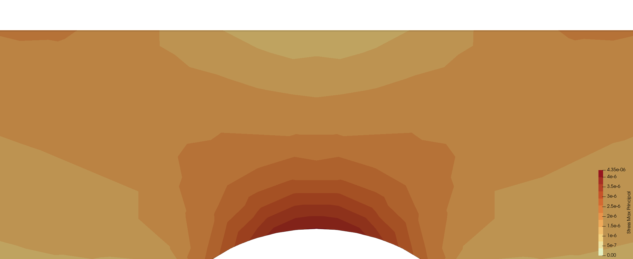

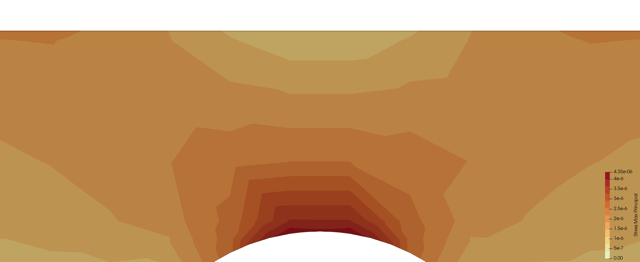

7.2 Stress field
Figure 3 compares the maximum-principal-stress field between the immersed IGA solution on the finest \(p = 2\) mesh (Figure 3 (a)) and the body-fitted Abaqus reference solve (Figure 3 (b)). Both are rendered in ParaView on a shared color scale — the Abaqus fields come from the VTU that the reference test case exports from its ODB — so the contours compare directly.
(a) Immersed IGA solution (case immersed_h4p2, \(h = 0.375\), \(p = 2\)).
(b) Body-fitted Abaqus reference solution.
Figure 3: Maximum principal stress on a shared color scale.
The tabs below extend the comparison to every case in the study, on the same shared color scale — flip between the Reference tab and any IGA case to compare contours directly.
Full coupon

7.6 Local refinement
The local-refinement sweep keeps the \(p = 2\) background at \(h = 3\) and refines the cells near the hole’s cylindrical face, named by the hole set, to level \(L = 1\), \(2\), and \(3\). Each case is a single refinement at the deepest level with two-to-one balancing, so the intermediate levels grade in automatically. The refinement offset is left unset, so it defaults to the degree times the element size at that level, \(p\,h/2^L\). The finest refined cells match the uniform \(h = 1.5\), \(0.75\), and \(0.375\) meshes.
The tabs show the maximum principal stress near the hole at each level, with the refined elements drawn over it, on the same color scale as Figure 3.
