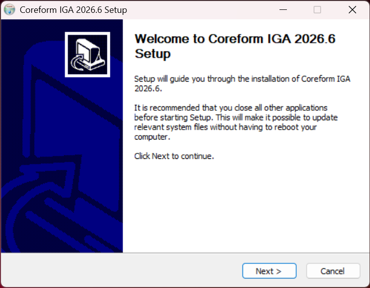

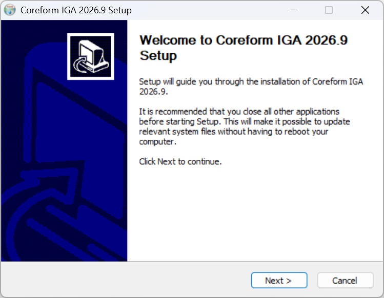

  1. The welcome page recommends closing other applications before starting the installation. Click Next to proceed or Cancel to cancel the installation.
    Welcome to the Coreform IGA setup wizard.

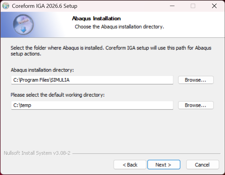

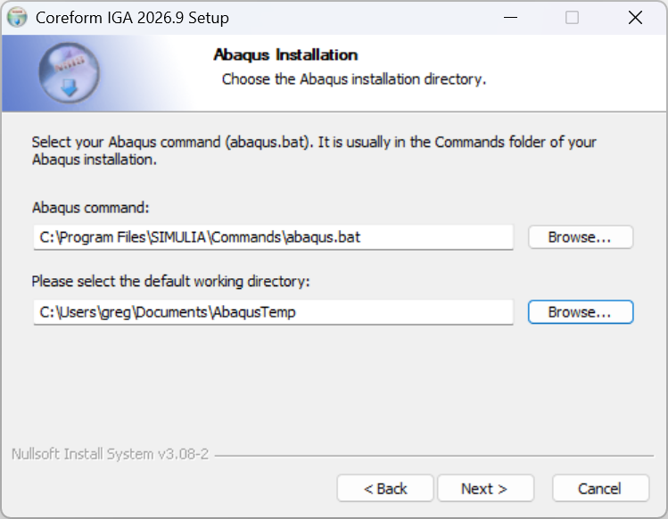

  2. On the Abaqus Installation page, confirm or select the abaqus.bat command for the Abaqus installation you want to use. This file is usually in the Commands directory of your Abaqus installation. The installer may fill this field from ABA_COMMAND, your PATH, or the standard SIMULIA Commands directory, so confirm that it identifies the version you intend to use.
    Also select an existing, writable default working directory. The installer uses it as the Start in directory for the Start menu and Desktop shortcuts, so Abaqus/CAE output files from those shortcuts are written there. Click Next to proceed.
    Select the Abaqus command and default working directory.

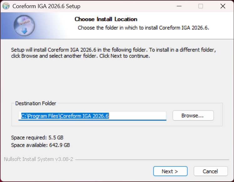

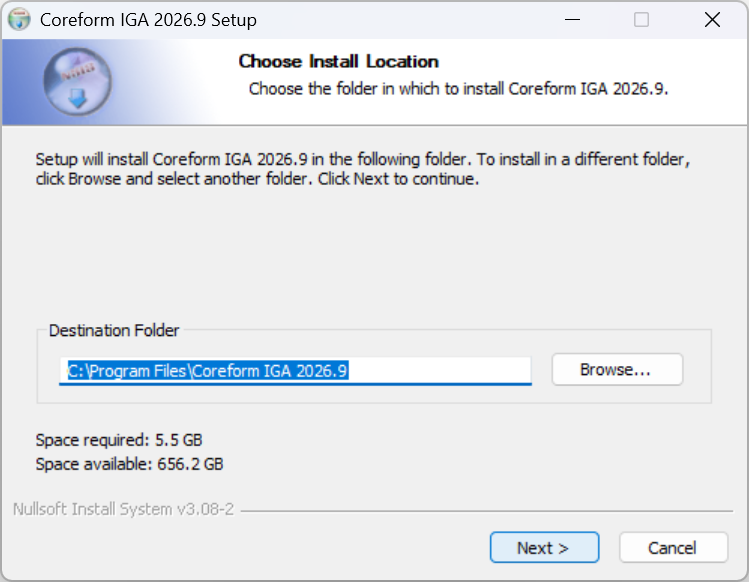

  3. On the Choose Install Location page, accept the recommended default installation directory, or click Browse to select another directory, then click Next.
    Choose where to install Coreform IGA.

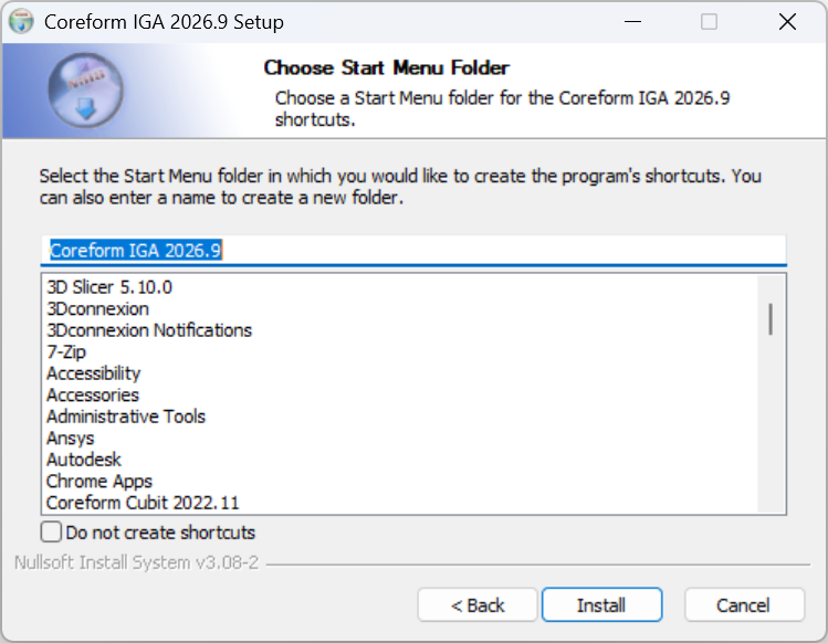

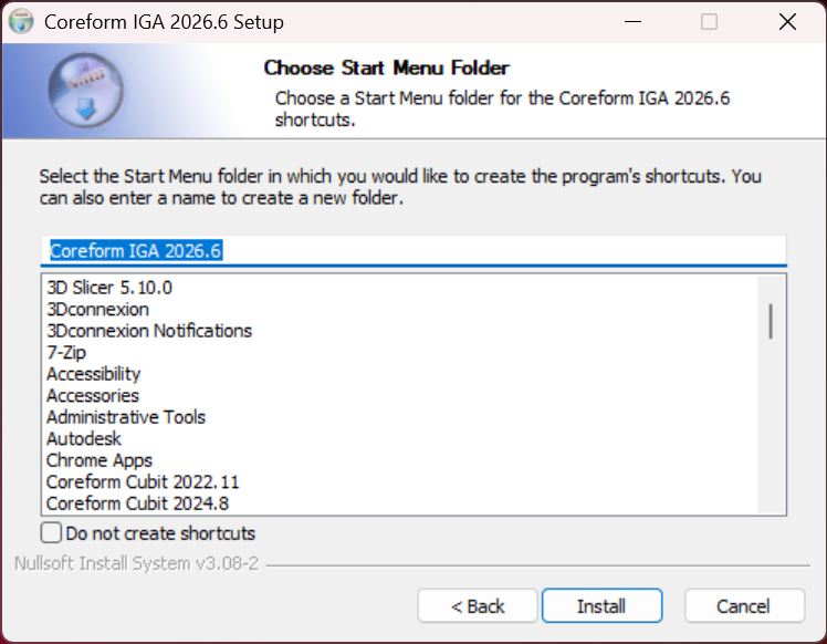

  4. On the Choose Start Menu Folder page, select the folder in which to create the Coreform IGA shortcuts. Leave Do not create shortcuts cleared: the installer’s post-installation check expects the Coreform IGA for Abaqus Start menu shortcut, and the shortcut enables the Windows Start menu launch method described here in this manual. Click the Install button to begin the installation process.
    Choose the Start menu folder and create the shortcuts.

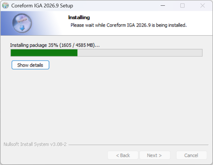

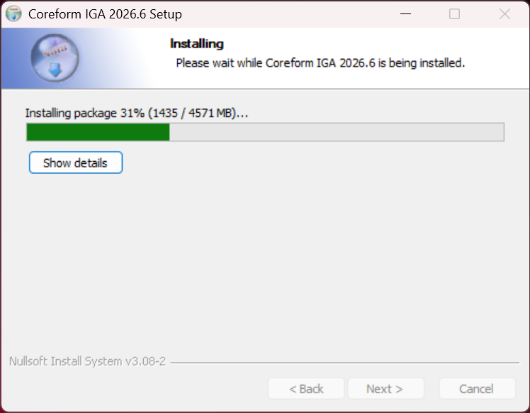

  5. The Installing page displays the installation progress. In addition to extracting the Coreform IGA files, setup installs the bundled Microsoft Visual C++ Redistributable, records the selected Abaqus command, creates the application shortcuts, and checks the Abaqus version and installed integration. Click Show details to see more information while setup is running.
    Monitor the Coreform IGA installation progress.

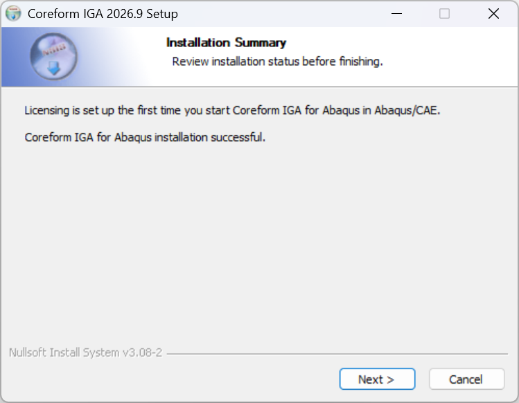

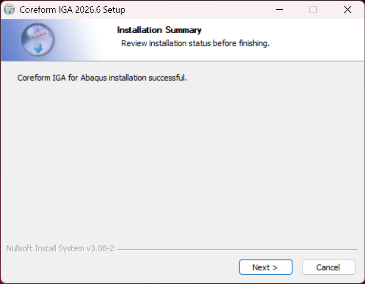

  6. The Installation Summary page reports whether Coreform IGA for Abaqus and its setup checks completed successfully. It also reminds you that licensing is configured the first time you start the application in Abaqus/CAE. A warning is displayed if the installer detects an unsupported Abaqus version or cannot verify the version; this warning does not stop the installation.
    If setup reports a failure, review %TEMP%\coreform_iga_installer_output.log, then contact your IT department or support@coreform.com if you need assistance. Click Next to continue.
    Review the Coreform IGA for Abaqus installation summary.

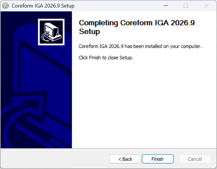

  7. On the final page, click Finish to close the installer. Then launch Coreform IGA for Abaqus in Abaqus/CAE and follow the first-launch prompts to accept the EULA and configure your license.
    Complete the Coreform IGA setup wizard.
