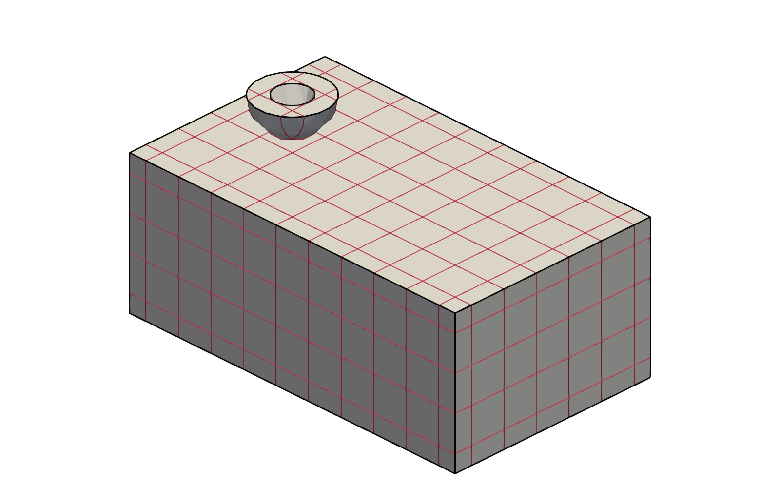

2 Geometry
The block occupies a \(5\times2\times3\) inch rectangular domain. The indenter is the bottom half of a hollow sphere, cut through its center by a plane parallel to the \(x\)-\(z\) plane. It has an \(R=0.5\) inch outer radius and a \(0.25\) inch inner radius. The geometry and initial position are shown in Figure 1. Its initial center is at \((-1.5,1.525,0)\), leaving a \(0.025\) inch gap above the block’s top surface at \(y=1\).
Figure 1: Initial contact-indenter geometry. The hollow lower-hemispherical indenter is centered above the left side of the elastic block; the small initial clearance is shown by a callout, and the inset identifies the indenter’s inner and outer radii.
Table 1: Geometric parameters.
Quantity Symbol Value (in)
Block dimensions \(L_x\times L_y\times L_z\) \(5\times2\times3\)
Indenter outer radius \(R\) 0.5
Indenter inner radius \(R_i\) 0.25
Initial clearance \(g_0\) 0.025

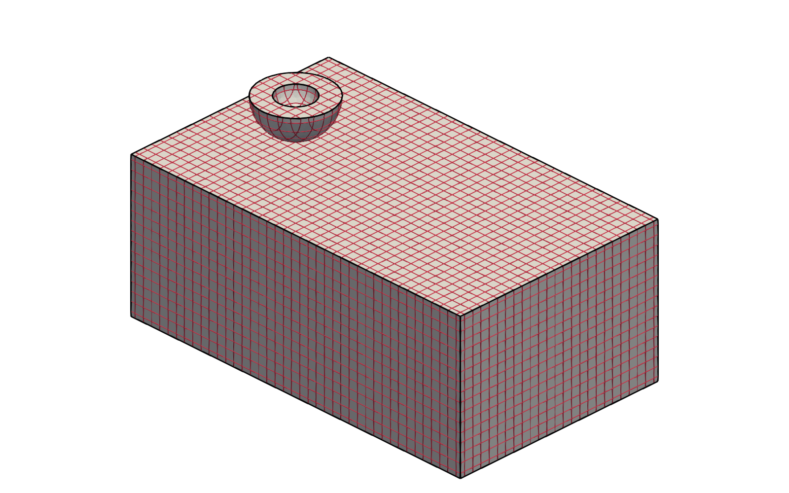

5 Mesh & discretization
The mesh study contains native Abaqus and Coreform IGA cases at refinement levels \(h_0=0.5\) in, \(h_1=0.25\) in, and \(h_2=0.125\) in. The Abaqus results use C3D8R elements. The Coreform IGA results use quadratic elements with \(C^1\) continuity.
The predicted Hertz contact diameter at full indentation is approximately \(0.447\) in. It is slightly smaller than the \(h_0\) mesh size, while \(h_1\) and \(h_2\) progressively resolve the patch. This makes maximum pressure a more demanding refinement quantity than the integrated reaction forces.
The tabs below show the Coreform IGA discretizations at each refinement level. Trimmed Bézier element edges are shown in carnation and CAD edges in black.

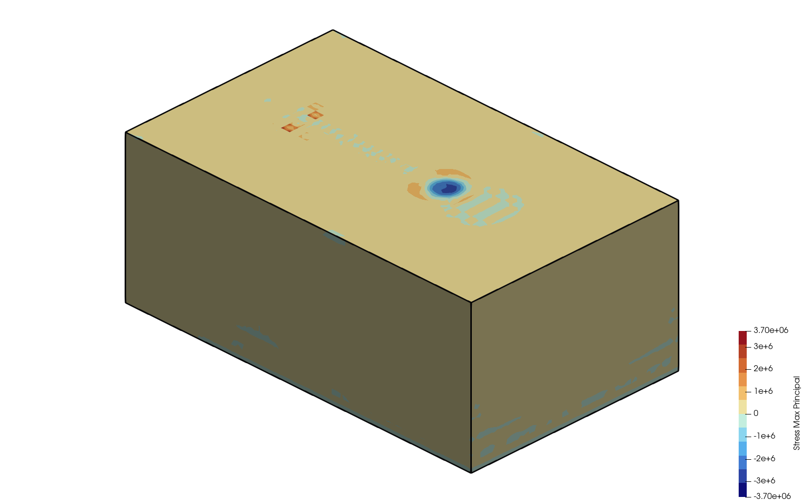

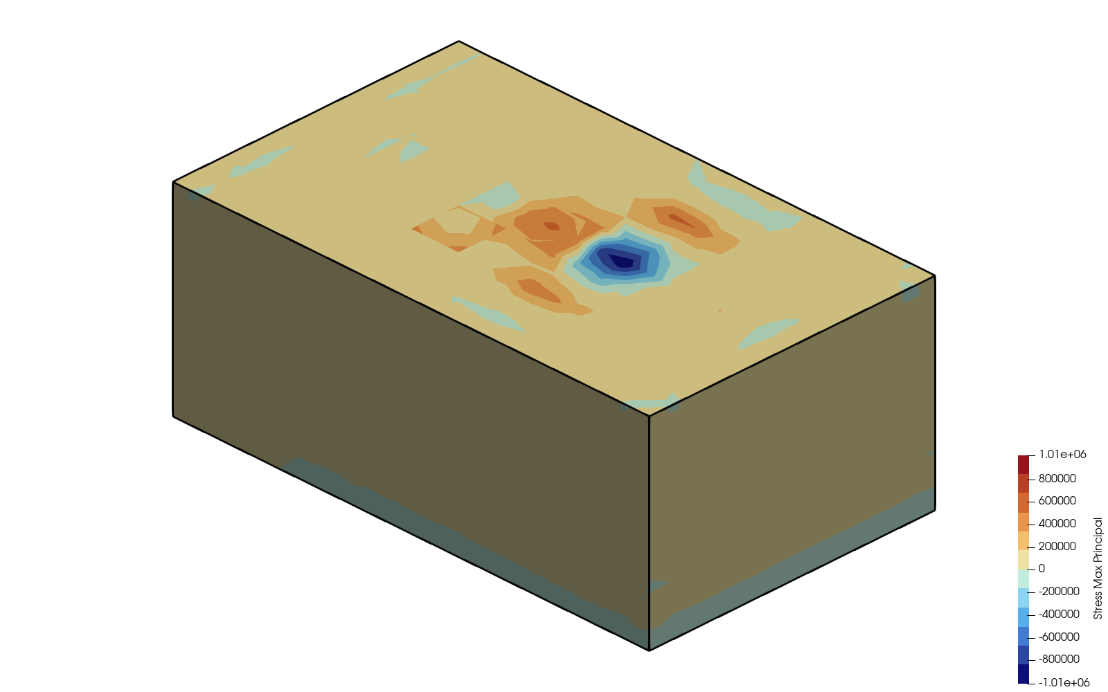

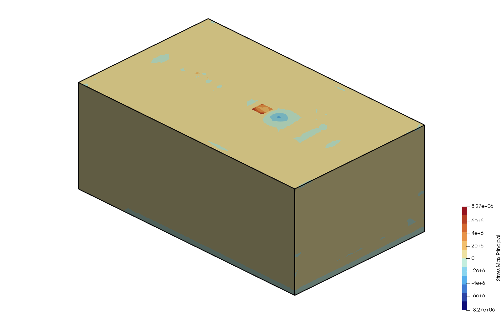

7.4 Maximum principal stress countour plots
The maximum principal stress is shown on the elastic block at \(t=0.55\), during steady sliding. The indenter is omitted to expose the stress field on the block’s contact surface.
