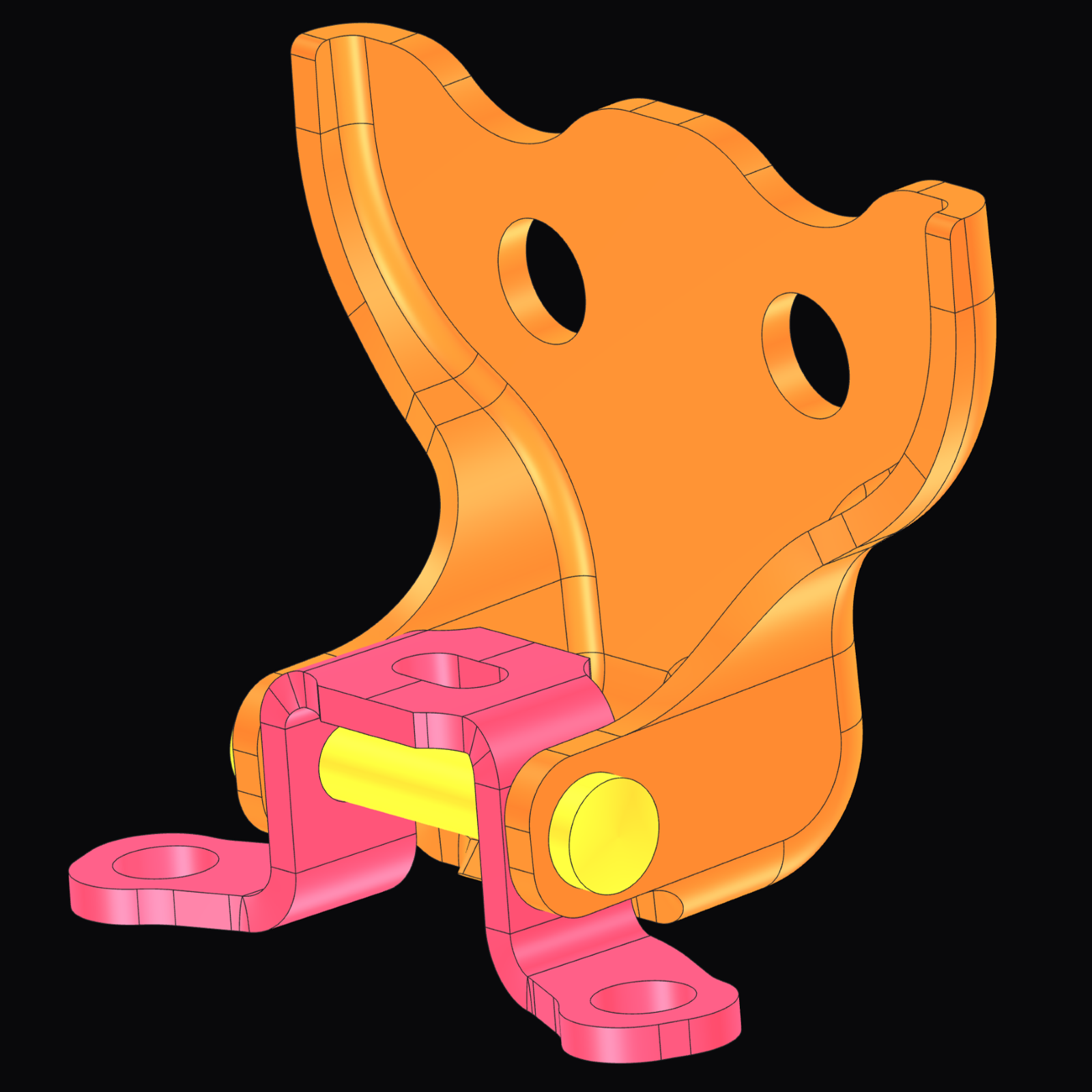

Figure 1: Door-lock assembly showing the hinge in orange, the link in pink, and the connecting pin in yellow.

This example demonstrates contact-driven load transfer between three deformable, immersed isogeometric analysis (IGA) parts in an Abaqus/Standard static analysis. The assembly consists of a hinge, a link, and a connecting pin. A prescribed displacement pulls the hinge while the link is held in place, and the load is transferred through the connecting pin.
